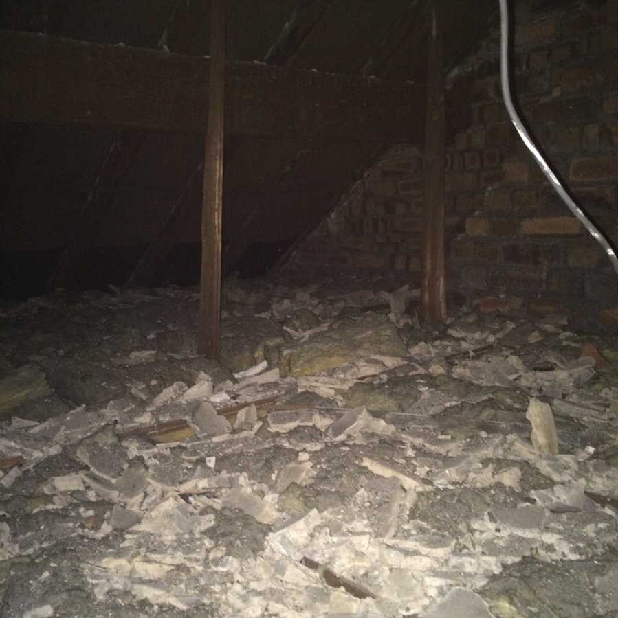

I've paid very little attention to my loft space since buying the house last year, but I'm looking to put some boards up there for storage. I stuck my head up there yesterday and was surprised to notice that there is a lot of debris sitting on top of the insulation. I can't quite work out where it's come from.
The house is old (built 1904) and I don't know what work has been done on the roof or when. I can see some small remnants of what looks like a lath and plaster ceiling, which has since been replaced with plasterboard. In between the joists (and raising to a few inches above them) is yellow fibreglass insulation, and it's on top of this that the debris sits. It looks a bit like broken up plaster, but I can't tell for sure. The underside of the roof itself is covered with felt and there's no damp or any obvious signs of damage.
Can anybody shed any light on what this might be? Obviously, it looks like I'm just going to have to do the dirty job of getting rid of it all but knowing where it's come from would be helpful.
Also, any general tips on roof boarding in an old house would be great. Thanks in advance.

Its called "Parging" and was a type of lime mortar which was stuck against the slates by pushing it against the battens. Due to age of the roof and wind etc it usually falls into the loft. It isn't harmful in any way.
In the photo it looks like you have newish felt which would fit in with having a new roof at some time and this has fallen into the loft.

They call it "torching" where I come from.
A modern felted roof, or one with breathable membrane, doesn't need it. IIRC it was supposed to prevent wind, and industrial pollution particles, blowing in between the tiles. Lofts in old cities often have bucketfuls of heavy black dust, probably from coal fires.
