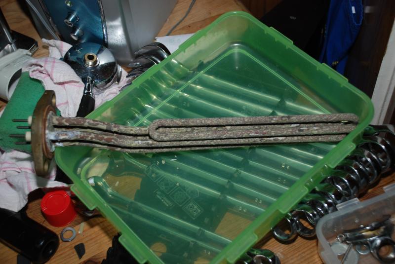

does this also mean disconnecting one of the terminals, and run using just one of the elements, means the machine will not work?
Removing both strappers and powering up only one element will mean the water will take twice as long to reach the right temperature.
That will only be problem if there is a supervisory timer that limits the time the heater can be on.
Though the wait for coffee will be longer and that could be a problem. :oops:
the bottom of the two elements is larger than the top. it wont be the recovery so much as the initial heating that will be the problem.... but obviously this is not ideal
