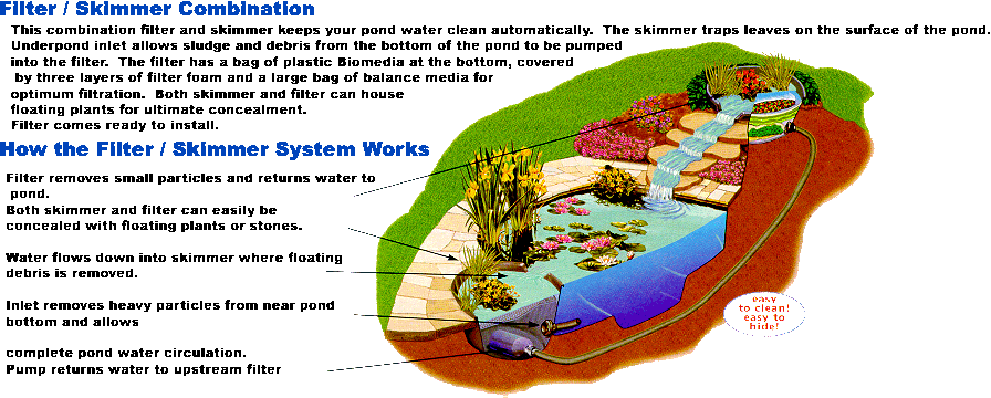

The waterfall pond setup looks similar to this. At the bottom of the waterfall, there is a pond with a skimmer which house the pump

If the set up is like the picture you posted, where is the problem?
In the diagram, the inlet to the skimmer section is positioned quite low so the sump ( skimmer part of the pond) will always be full of water, even if there is a power outage.
Can't the inlet be repositioned so it is much lower? Surely that is a beeter solution than having to restet a cutout device?
Or have I missed something?
I think you have missed something.
its a drawing you are looking at, not a picture which is what io asked the op for.
I agrree there has to be a better idea, but until we get a picture, not a lot we can do.
