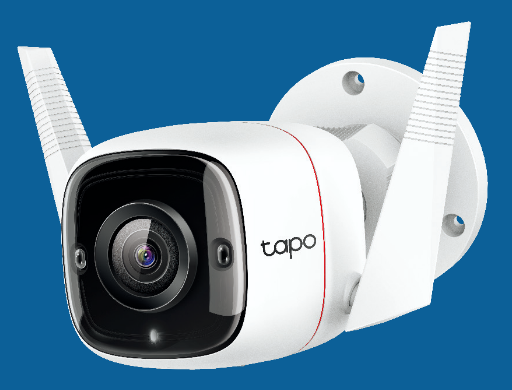

At the moment I have 2 Tapo out door cameras and one Calex indoor camera running off of a 110Amp/hr battery that I keep having to bring home swap and charge all the time.
Would like them to run off of solar panels and the 110 battery on there own. So any ideas please on solar panels to buy?
PS the 2 Tapo cameras are 9 volt, and i have a drop plug for them to work and the Calex is 5 volt USB

But the 35 Ah AGM on the mobility scooter used even less to the Jag. And the 20 Ah AGM in the jump start battery pack even less again. So we have to ask is it worth it? I can so easy recharge the jump start pack, and so easy to carry, likely better simply charge it up one a month, I looked for a Tapo 9 volt camera found this 1757409092383.png but nothing to say how much power it uses. But there will be losses with the devices to get 9 and 5 volts from a 12 volt battery, well not even 12 volts really on charge can go to 14.8 volts depending on charge controller, and most droppers have an auto switch off at around 11.8 volts.

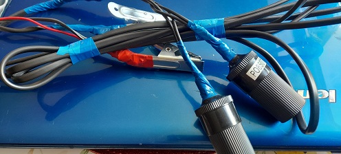

I was looking at using 2 x 80 Ah batteries which were on a car as emergency lighting, and I still need to look at cheap methods, I have a lead, Emergancy power kit.jpg so two cig lighter sockets on croc clips so easy to connect to a battery. So two methods to use it, I have lights designed to be used when working on the car, small tungsten bulb, and a magnet to hold it on the bonnet, and also some USB adaptors for a car, and USB desk lights. As yet not measured how much each uses, ones first impression is the LED USB will be better, but there will be losses getting 12 volt to 5 volt so until I measure I will not know.

View attachment 392220 but nothing to say how much power it uses. But there will be losses with the devices to get 9 and 5 volts from a 12 volt battery, well not even 12 volts really on charge can go to 14.8 volts depending on charge controller, and most droppers have an auto switch off at around 11.8 volts.

That is the camera I use (or 2 of them) typically a 110amp/hr battery lasts a week before it needs recharging
110 x 12 / (24 x7) = 7.85 watt/hours. My 6 kW solar panels clearly can produce a lot on sunny days, but December 2024 they produced 97 kWh = 130 watt/hours average. So 6/130*7.85=362 watts. So you will need a 400 watt panel to run the cameras.
