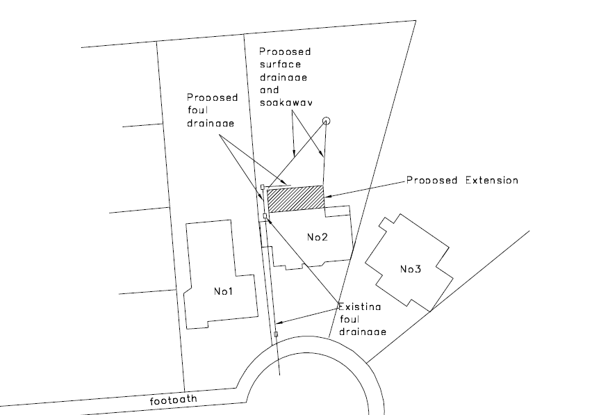

My experience as below, dwgs approved by BC no involvement with water company, why would they want to be involved, I already paid for sewerage services and all new pipework and connections deemed my responsibility. In the end due to clay soils and soakaways being impractical surface water also directed to existing combined drainage system (BC went along with it and again no involvement with WC)
As per your drawing, a connection was being made on the property to the existing foul sewer, and in effect it was only being extended around the footprint of the proposed extension.. In this instance the OP want to make a new connection to an existing sewer, and has no idea if the sewer they are proposing to connect to is combined, with too many assumptions being made.

Disagree, Op is making a connection to an existing sewer same as I did. As for contradiction, yes I should have said "new surface water cannot without agreement from the WC". I side stepped that requirement ( naughty boy?) :)
How do you know how others are reading it, but yes you are misunderstanding the OP. He has a sewer at the back that runs into a combined system and a sewer at the front ( even though its only transporting rain water at the moment) which also discharges into the aforesaid combined system hence its all part and parcel of a combined system. If the OP says otherwise I will gladly ( well not gladly but accept my misinterpretation is wrong) eat humble pie. OP to clarify?
