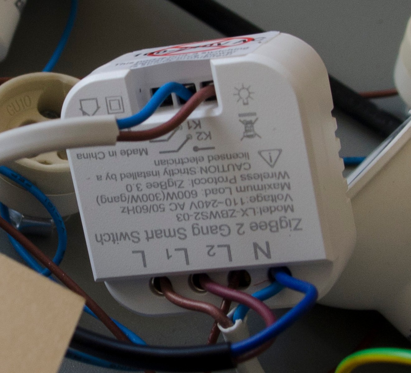

But in the main we do as @bernardgreen says hard wire lights. And it does not really matter is tungsten, discharge or LED the wiring is the same. Clearly turn off the lighting MCB or RCBO and they do all switch off using same switch. But in the main we want to control groups of lights or single lights, not all, and we want the control where it is convenient.
We don't know where convenient for you, or how the lights are wired now, I can say how it would be done in my house, but that does not really help you.

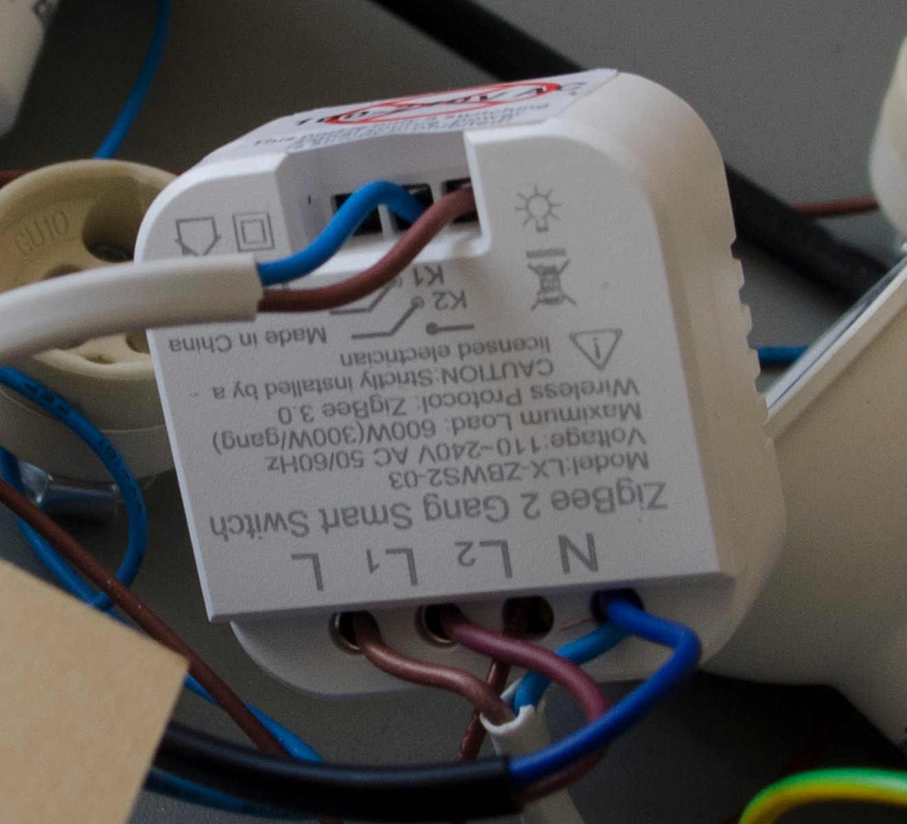

I am waiting for my son with ladders to fit a new light above my stairs, and this light has so many ways to switch it. This little device DSC_6061.jpg will allow me to use the switch on the landing, switch in the hall, or my phone to turn lights on/off. Today there are 100's of these devices and so many ways to hard wire, the old idea of one system is used in all houses is gone, personally I don't have lights on voice control, when Bill Bailey on TV said "Hay Alexis turn off all lights" I was unaffected, but we have not got a crystal ball, we don't know what you have got already.
