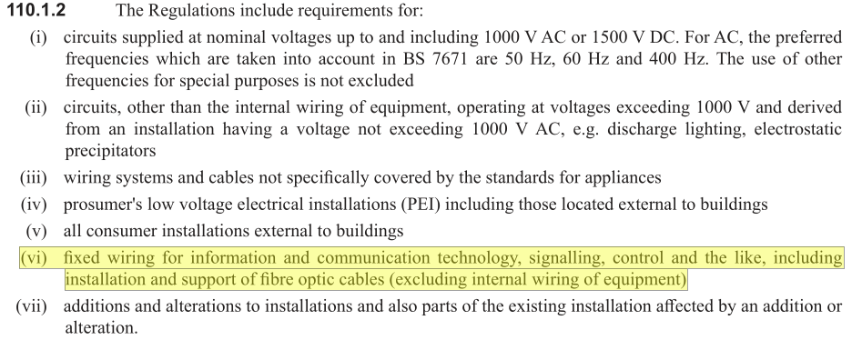

I need to run a 4mm twin and earth cable in a 150mm zone at a corner of a room with a network cable from the ceiling void to under the floor boards to an island in a dining room, is this advisable if I had the power say one side of the 150mm and the cat five the other side ?
SELV cables don't have to follow the same rules as LV cables.
<image of 110.1.2 in BS7671>
As you illustrate, 110.1.2 does, indeed, say that (with my emboldening) "The Regulations include requirements for:" followed by a list of eight things, but it presumably is not suggesting that all the regulations in BS7671 contain requirements in relation to all those 8 things.
So, in context, I suppose the question to be asked is about which of the regulations relate to the routing of SELV cables? Are you saying that the requirements are exactly the same for SELV cables as for cables carrying higher LV voltages?
Kind Regards, John
Whether it's SELV, data or LV, things such as prescribed zones, installation methods, appropriate means of support to prevent premature collapse in a fire, not permitted in locations such as protected escape routes and so on all apply.

I don't think you're right about 'prescribed zones' etc.). As secure suggested (and you disagreed), even in Amd2 a combination of 522.6.202(ii) and 522.6.204(v) means that buried and 'unprotected' SELV and PELV cables do not have to be in 'safe zones'. Is that not correct?
Some of the things you mention make sense - for example, any cable, no matter what it is carrying, can be a problem if it collapses in a fire and/or impairs escape routes (and the same can, of course, be said for plumbing, structural elements and even things like curtain tracks).
However, I think that, in general, the answer to my question is probably not that straightforward, since, even given 110.1.2, I don't think the fact that a regulation BS7671 'requires' something can (given that the regulations are not 'exhaustive' in considering all possible situations0 necessarily be taken to mean that the requirement relates to any cable/circuit, even if SELV/data/whatever (or even DC), can it?
To take just one example (of what I suspect are many), and sticking with 522.6.202, it would seem that, if taken literally, this regulation requires that a cable buried within 'safe zones' which is carrying LV (not ELV) and which does not have an outer earthed sheath/whatever or mechanical protection has to be RCD-protected, even if the "LV" it is carrying is DC!
Kind Regards, John
