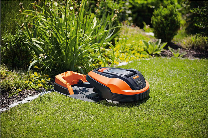

Hi all
I've recently moved house and need to setup my robot lawnmower before the summer has been and gone!
I've got a socket in the kitchen that I'm sure we can run an outside socket from, but I could also just drill a hole under the socket to outside, put the cable through the wall, and plug it into an unused socket in the kitchen? My spidey senses are tingling that this might be a bad idea, so coming for reassurance that this will only look unprofessional, and isn't unsafe?
its a manky way to do it!
The socket outside must be of a suitable IP rating (it IS going to rain).
Safety - is the internal socket RCD protected? Any electrics outside must be protected by a 30mA RCD. this may be part of your fuseboard (consumer unit), or you can get plug-in ones.

You're spidey senses are warning you that if you drill under the socket, you may hit an electrical cable. You need to ascertain where the cables are before you drill into the wall.
You may well have an RCD fitted on your fuse board, and if you use Taylors suggestion (a very good one mind you) then there's no guarantee that both RCDs won't go at the same time, but the beauty of Taylors idea, is that you don't have to mess around with the electrics trying to fit just the IP sockets outside.
You can do a neat job by drilling from the inside (once you know where the cables are), feeding the cable through the wall from inside, putting in a loop so that any water runs down the cable and not into the box, and then wiring up the cable inside the box to take out any excess cabling. Seal any holes with sealant, and you should have a nice job.
I am thinking your looking at something like this
It does not say what the IP rating of the docking station is, but one would assume it is designed to be left outside 24/7, the most important thing is the RCD protection, and you want the RCD feeding the docking station to be able to trip without taking out the whole of the house, so either a RCBO in the consumer unit, or a 10 mA RCD which we hope if damp gets in will trip before the main house one

A lot depends on the quality of the docking station and its ability to resist water ingress. A 10mA RCD is likely to trip before a 30mA RCD trips if the earth leakage current increases slowly but it would need to disconnect both Live and Neutral to avoid the Neutral Earth leakage tripping the 30mA when the docking station get more wet and electrically leaky.
Peronally I would supply it from a dedicated circuit with its own RCBO on the consumer unit.

Thanks for all of the posts, only just got round to doing this on my lunch break today. Ended up drilling a hole and running through one of those pre wired outside boxes as posted above (with RCD). Put sealant around the hole, mounted it, works a treat!
Point on tripping the freezer etc noted, just have to hope for the best on that one
Looks pretty neat too (and saved me a few quid). Thanks again
