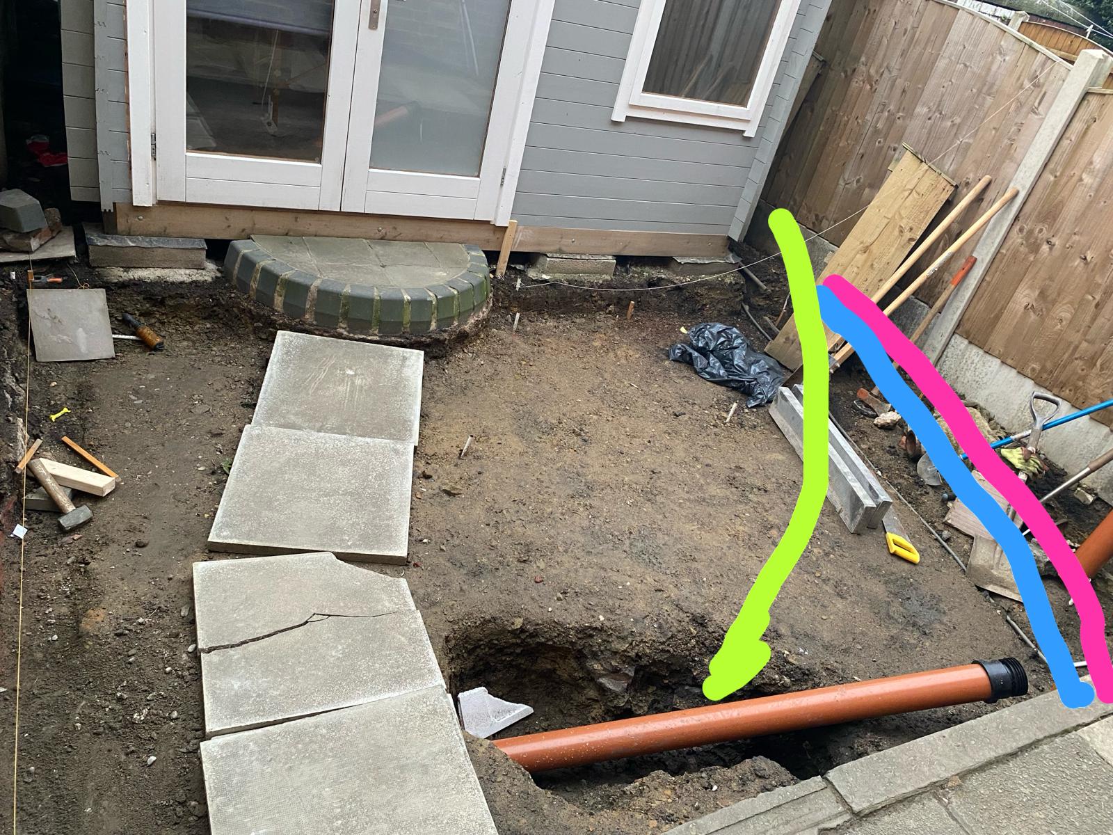

I work in my log cabin (sports massage) and while I’ve dug down for my patio and drainage, now would be the time to install a sink and run the water pipes from the house and Install a sink in log cabin.
Just a couple of questions:
1. The sink waste would come out of the log cabin… do I run a 32mm solvent weld pipe all the way to the 110mm underground pipe (for the aco drainage, and connect to that) , or do I have to connect it to a 110mm pipe as soon as possible?
2. The gold and cold feed from the house - is push fit plastic pipe okay to run underground and into cabin?
3. Is there a particular depth (below finished patio) that these need to run?
Pic below for reference
Blue / pink line is cold/hot feed from house
Green would be waste from log cabin sink
Cheers
Drainage, run 110mm to the Cabin, fit a gully and drop waste into that. Presuming it'll be connected to a Combined Drainage system, otherwise it'll need to be kept separate from the Aco Drain.
I'd run just cold water, and fit a suitable water heater in the cabin, otherwise it'll take a week to get hot water through to the cabin, You'd be wasting copious amounts of water and energy otherwise. Blue MDPE needs to be used underground.
Water needs to be deep enough to give protection from frost. Drainage, deep enough to avoid damage from anything that may penetrate the surface, if under a patio, make sure pipework is suitably protected before covering.

Thank you for your help much appreciated
