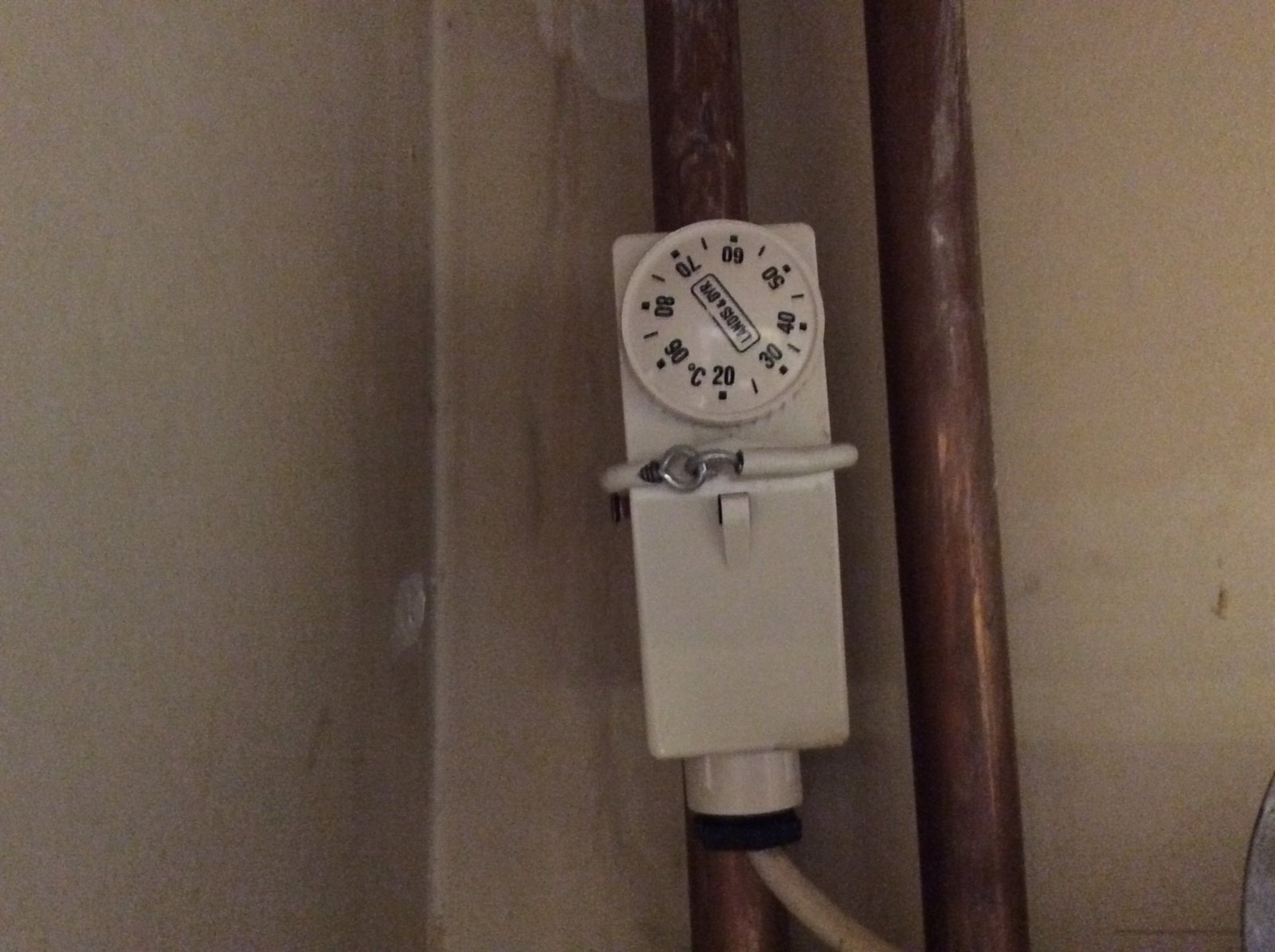

There is a bimetallic contact thermostat on the HW feed from the boiler. I have taken this off and at low temperature it is open circuit. It goes to short circuit as the temperature rises. Picture attached
Should this bimetallic contact thermostat be the same as the room thermostat in operation? For example. If I set it to say 45 deg C. The contacts would be short circuit until it reaches this temp and then go open circuit?

Sorry I should have said that on this bimetallic contact thermostat there are 3 connections.
The installation leaflet says:
Terminal 1 = common
Terminal 2 = opens the circuit when temperature rises.
Terminal 3 = closes the circuit when the temperature rises.
The wires are connected to terminals 1 & 2 but as per my previous post it “appears” to work the opposite way round.
Should I swap the wire from terminal 2 to 3?
Thanks once again
Chris
Unfortunately it looks like it will need someone with test gear to follow the live back from the boiler and find out where it is coming from. Over a forum we can but guess, and there could be many different causes of the problem.
Unless you have changed anything, there is no point is swapping wires around. If the system used to work OK, then the wires will be OK, they won't have moved themselves.
Also, your photo is not of the cylinder thermostat. The cylinder thermostat will be clamped onto the hot water cylinder about one third up. The one in the photo is clamped onto a pipe and is the sort of arrangement that would normally be associated with a frost protection system, it being there to stop the system overheating when the frost thermostat (which will be mounted elsewhere) switches the heating on. The air sensing frost stat should be set at 5 degrees, and the pipe stat at 20-25 degrees.

The only reason I was going down the bimetallic contact thermostat was I remember that the engineer who serviced the boiler said that same pipe was leaking. During the summer so heating was always off at that time.
