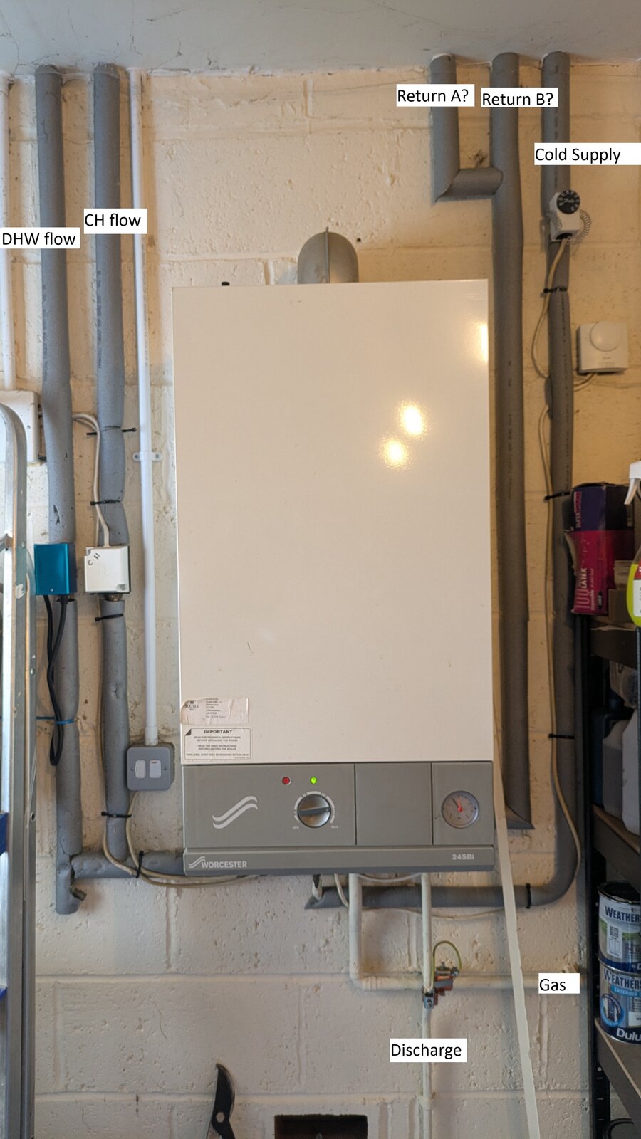

Hey. I’m looking to replace my 18yr old and occasionally temperamental Worcester system boiler with something efficient and reliable, possibly a Viessmann 100-W system boiler. With a smart thermostat that would ideally give modulation control (pref using OpenTherm). I plan to keep the Megaflo cylinder and would hope to avoid changing pipework to the Megaflo or radiators. It is an S-plan setup at the moment. I’m struggling to get quotes for anything other than a drop in replacement keeping the S-plan setup.
Am I right in thinking/hoping that a boiler with an internal diverter valve would only require some relatively minor re-plumbing in the garage (see photo) and then a PDHW setup could be achieved, allowing high flow temps for HW cylinder recharging and lower and variable flow temps for modulated CH control? So allowing the boiler to operate in condensing mode most of the time.
Am I overthinking this? Are the gains vs the S-plan setup likely to be marginal?
Any advice welcomed.
In simple terms - Yes.

Not relative to your question and just an observation, but the nomenclature in your photo shows the frost protection pipe thermostat fitted on the incoming cold water mains supply pipe. :unsure:
The idea of the frost protection system is that the wall mounted frost stat switches 'on' when the ambient temperature drops to a value slightly above where freezing might occur and starts the central heating. Once warmed water (i.e. not hot, but warm enough to eliminate a freezing risk) gets back to the boiler it is picked up by the pipe stat which is fitted to the return pipe which switches the heating off. However, as your pipe stat is on the incoming cold water mains that will never happen so the heating will continue to run.

So shouldn't be a plumbing change apart from in the garage. How about wiring? I think in the Viessmann case it needs a low voltage stat, so would need a Viessmann Cylinder Demand Box. Is it probable that can be fitted at the garage end, using the existing signal from the Megaflo CL250HE?
As I understand it from online posts it can be a right pain in the a*** to get DHWP to work with Viessman boilers due to the demand box requirement. There is a good thread on the Buildhub forum.
As others have said, I'd be looking at an alternative to Viessmann for this
