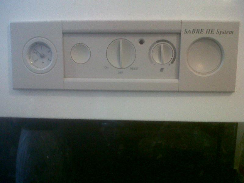

I've had a Sabre 29HE boiler for over 3 years in a 4 bed house, for some time I've had to get used to the fact that the unit has no timer or programmable control on the front panel. Not a very efficient system as to get either hot water or central heating the whole system has to be switched on manually and turned off when not needed.
There's a blank circular panel where a time clock could be fitted, but this may only solve one problem...
A pain in summer as when all the radiators are switched off we still have to remember to switch the boiler on each day for hot water. A pain in winter as the hot water gets overheated while we need to heat the radiators.
The house has rooms on 3 floors, the loft bedroom has two radiators which have never worked. They have been bled but without any affect. A room thermostat is in one of the other bedrooms but seems to be disconnected as it has never worked.
We plan to sell the house next year but don't want to spend on a new boiler as we won't be around long enough to see the benefits ourselves.

That boiler is not that old as its condensing and if working most would say its fine to keep it.
You seems to have put up with a budget boiler installed without the proper controls.
So just before you move is rather late, but better late than never.
A programmable thermostat is probably the best option for the CH and a simple thermostat for the hot water.
Proper controls could probably be seen as a sales feature!

the sabre 29HE is a combi boiler so you should get instantaneous hot water are you saying that you have a hot water cylinder installed as well ?
cheers Tony
have never seen one and didnt even know such a beast existed
