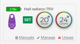

In other down stairs rooms we have these
which unlike the cheap eQ-3 report not only target but also current, they claim to monitor both water temperature and air temperature so can compensate for the direct heat from the radiator, but no window open detection, and the main problem is no real local control, have to use the phone, and although when bought claimed to work with Nest, they don't. You can set geofencing using IFTTT, and they are wifi connected not just blue tooth like cheaper ones, but cost around £38 each, and really a waste of money, either you want than to connect to the wall thermostat, or want cheap, these do neither.
