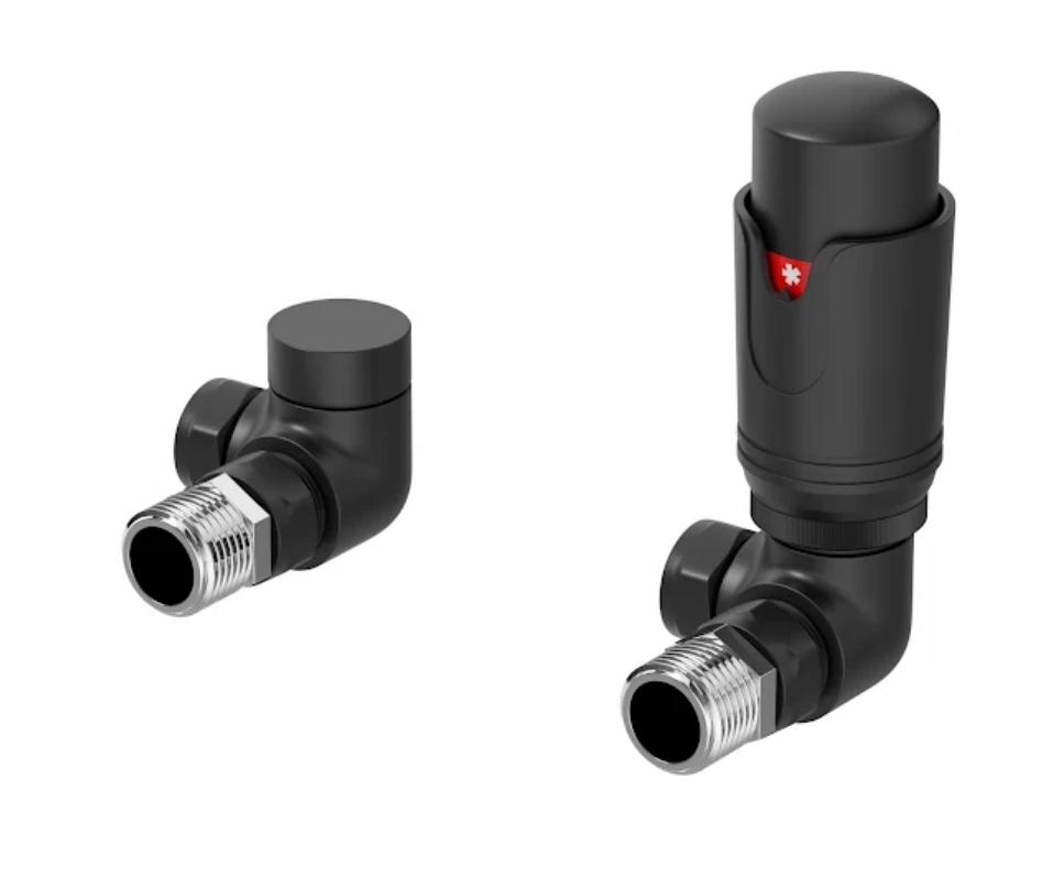

The vertical radiators have the input and output on their sides. The 15mm pipes will come out of the wall. I have identified I need a "corner" radiator valve, but on the photo it looks like it would be fitted only on the right hand side of the radiator, because if on the left it's be facing downwards?
2023-12-11 22_05_08-DuraTherm Corner Black Thermostatic Radiator Valve Pack - 15mm.jpg

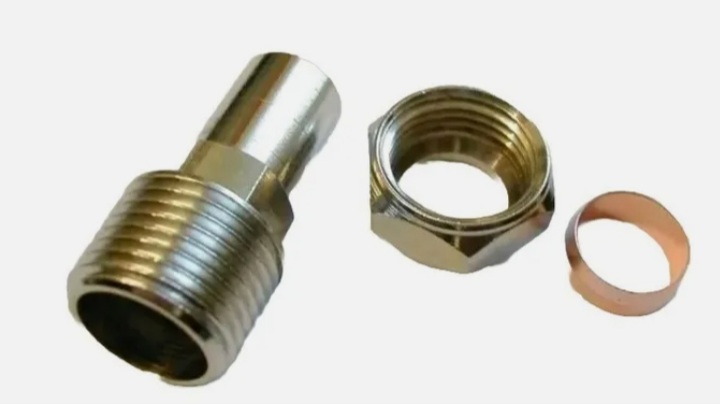

The silver bits with the screw threads are the radiator 'tails'...
These attach to the radiator.
The lock shield and valve, can then join to the tail through either of their ports - just imagine that the nut in the above picture was coated black, instead of chrome.
Ah thanks, I see it now, it is black and I could not see well, and thought the radiator side port was different but they are both compression fittings with a nut and olive, and a "radiator tail" attachment.
All I need to find now is the lockshield+ drain system, so that I can drain and remove a radiator without draining the whole system.
