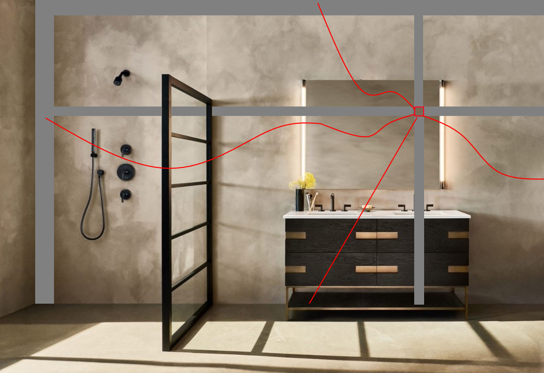

Right, so let us start again:
A back box or just a cable exiting the wall - the red square - is to be installed at a position that will be hidden by the illuminated mirror.
The cable for this mirror will obviously have to be installed before the mirror is hung (not to mention before the wall is tiled) so it will not be there.
So, instead of chasing the wall and fitting the cable vertically or horizontally from the red square in the shaded grey areas, you two are saying that it would be compliant with the regulations and perfectly understandable to chase the wall and install the cable where any of the red lines is - or any infinite number of other similar routes.

Right, so let us start again: ..... A back box or just a cable exiting the wall - the red square - is to be installed at a position that will be hidden by the illuminated mirror. .... The cable for this mirror will obviously have to be installed before the mirror is hung (not to mention before the wall is tiled) so it will not be there.
You have merely produced a variant of the diagram I posted in #26.
I was not "saying that it would be compliant" to have the cable buried in any of the routes shown by red lines in either of our diagrams - it was surely obvious that I posted my diagram to indicate that I would consider it daft IF that were permitted by the regs.
By including in your diagram (in grey) the 'permitted zones' that would be created by a backbox if it were visible, what do you think that adherence to those zones would achieve when the box was not visible?
... and what if the cable simply came out of a half-inch diameter 'hole in the wall'. Ignoring the fact that that point would again not be visible, how 'wide' do you think the permitted zones would be in that case?
