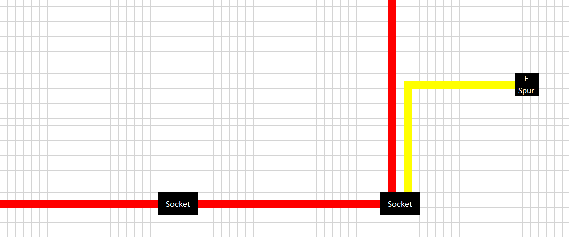

Hi all,
So i know safe zones are created at straight lines from an outlet, but can the following be done
Red shows route of ring main, and yellow shows proposed route for a fused spur
Thought so, as if you ever removed the double socket you'd remove power to the fused spur
Actually safe zone rules (and others) apply to the situation at hand. They don't involve what may happen if something changes.
