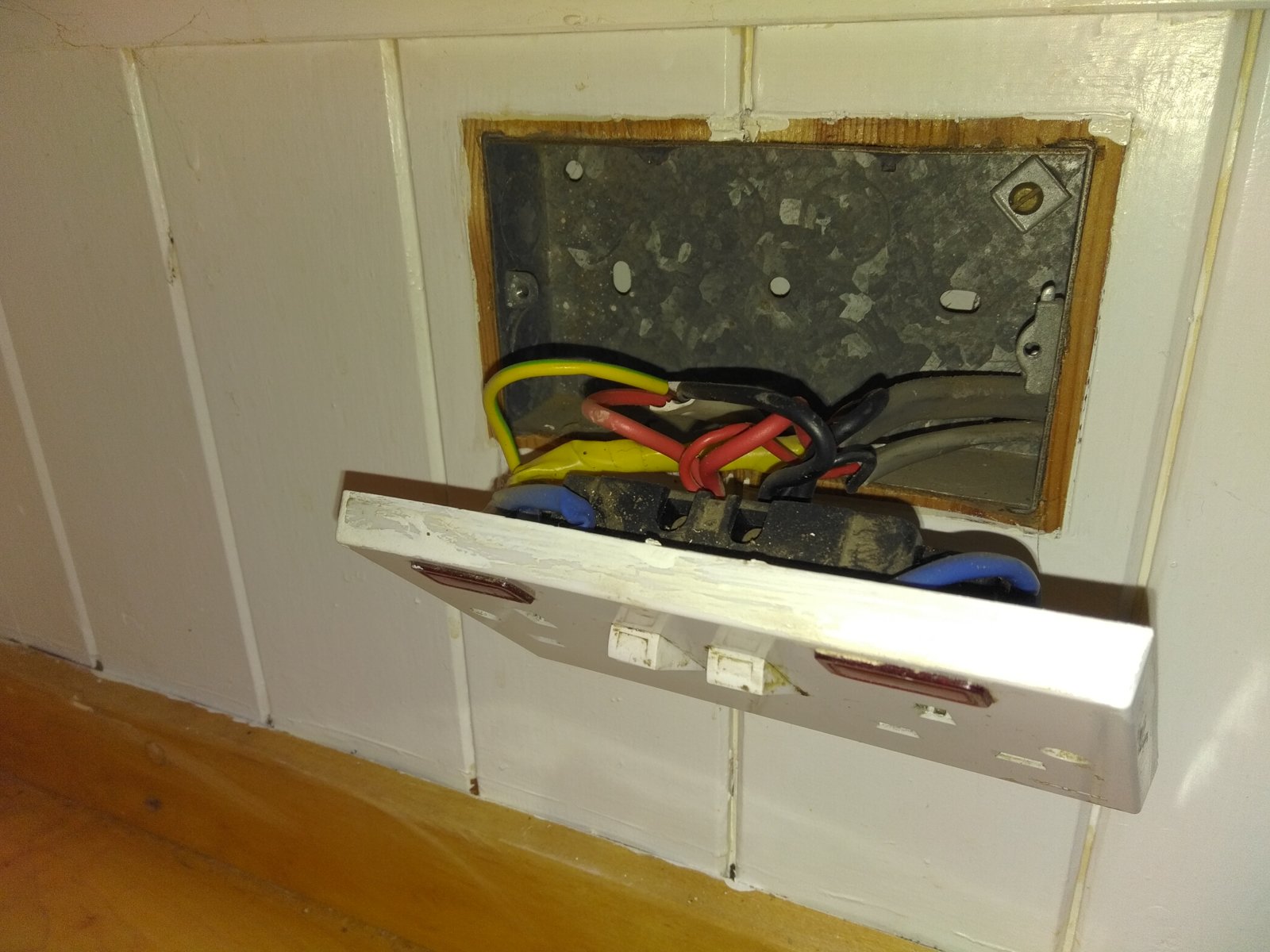

Meanwhile, in surveying the electrics, I found this behind one of the kitchen sockets ... and I *know* that white cable is feeding a spur. Yes, that is a 1mm cable in there, no gromits and no earthing on the pattress.
In fact, I've found the kitchen circuit feeds sockets in one of the downstairs rooms as well and most, but not all, of the sockets in one of the bedrooms. What's more, the double light switch between the utility and garage has each switch on a completely different circuit, there are other spurs off spurs, and the kitchen circuit isn't one of the RCD protected ones. To say this installation is random, if not just dangerous ...
That's not actually a requirement as long as the socket is.
No problem - apart from calling/labeling it a kitchen circuit.
Not a problem. Common practice.
Probably needs sorting.
Neither is mine. Whether it contravened the regulations when fitted depends when it was fitted.
You've surprised me there. I thought the pattress had to be earthed so that the screws were.
I'm also surprised that it's acceptable, even common practice, to have different circuits in the same switch fitting.
I do presume that the 1.0mm cable spurred of the kitchen sockets is potentially a fire hazard, especially as that 1.0mm cable then goes behind the Aga.
So long as there is an earth connection to the socket, the screws will be earthed by that, as will the back box when the screws are done up. Explicit earthing of the back box (with a wire) is, in my opinion, preferable, but earthing it via the faceplate screws is theoretically acceptable.
Kind Regards, John
It is specifically not allowed - it could be overloaded if it supplies a double socket.
To be fair to whoever did it, it only supplies a single socket that has a small PSU drawing about 30 watts (thermostat control for the Aga). But, a fault couldn't be relied upon to be able to trip the 32A breaker before the cable melted, I would have thought.
If you were to put a fused connection unit at the source, next to the socket it spurs from, you could fuse it a, say, 3A or 5A
Unswitched or somebody will turn it off. And preferably labelled (the PSU socket too)
Then that will be technically fine but as I said 1mm² twin and earth - not flexible cable - is specifically prohibited on a "power" circuit - whatever that is.
Yes it can (be relied upon).
One socket means not more than 13A could be drawn - let alone your 30 Watts, and -
a short circuit will trip the 32A MCB before the cable melts.
