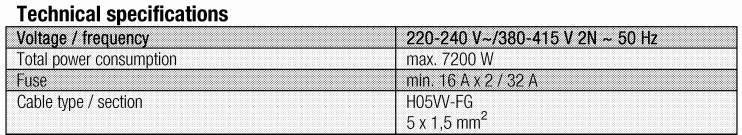

Had a look at hob instructions it tells you to use H05RR-F3G-1,5 which is rated 15 amp and it is 2.9 kW a Gorenje EC310AC domino hob it is supplied from a FCU so would assume fused to 13A. A useless hob I used a free standing Lidi induction hob sitting on top of it with the Gorenje hob isolated at the consumer unit as it is so useless.
The Beko induction hob which it replaced HII 64401T says in the instructions maximum 32 amp single phase and 2 x 16 amp when using 2 phases. It was removed by the council who installed the disabled kitchen for my mother as it had a warning about pace makers and my mother had a pace maker also she could not use the controls due to angle of view when sitting in a wheel chair, the touch controls could not be seen. Two months after it was ripped out, my mother had a new pace maker which complied with the standards so she could have then used the induction hob.
At home I use a stand alone cooker load 10466 - 12455 W it states minimum 32A supply it does not state the maximum. Since it can use over 50 amp I would not see any problem with a 45A supply, it is actually supplied with a 32A MCB which has never tripped. Very few consumer units could house a MCB over 50A and there is a Warning: This appliance must be earthed.
The Lidi induction hob does not really count as it is a portable appliance so supplied with a 13A plug. Oh and it is class II.
So it seems instructions do vary, so before using a twin outlet cooker connection unit we should read the instructions, I suppose I am guilty in the past for installing equipment without reading the instructions, simply as not there, some one else has unpacked the device and installed it and I have only been required to connect it. It is some thing which I have commented on before, all well and good swapping a 45A MCB for a 32A MCB but unless there is paperwork to say how installed swapping a 32A for 45A is not so easy, if a smaller overload is required with commercial premises we would use a fuse box at the cooker end. But with domestic there is no FCU which can take 16A or 20A fuses.
One of these in the kitchen is not really what we want to see.
In the instructions I have found, it actually says -
"Fuse - Min 16Ax2/32A"
http://be.beko.com/urun_detay.aspx?urn=15686&kat=4533&lang=en-US
Although after diversity, one 16A would theoretically be sufficient.
So, perhaps the so-called instructions are not written by someone who actually knows what they are doing, but merely adding up numbers.
The same, then, in different words.
23A after diversity so quite understandable.
