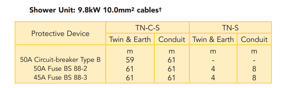

That you're asking here about what devices you should use doesn't indicate that this electrician is doing the design. And when you write things like "Obviously I'll have to run some 10mm from the board to the shower which is fine, I've done it before" one wonders how much of the construction he would be doing.
