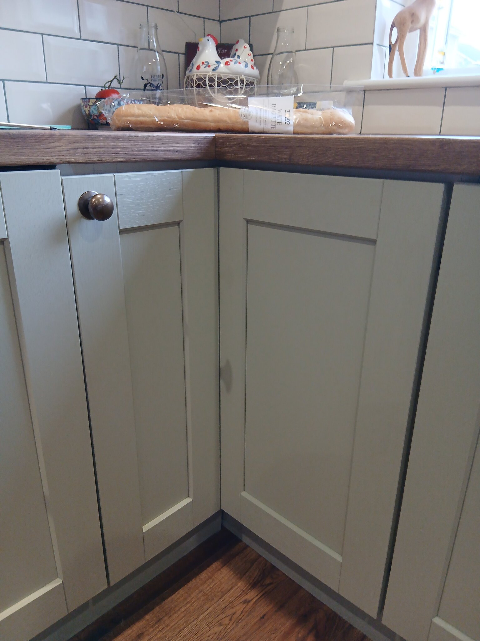

Hi can anyone advise what I need to do to correct the sag on this corner cabinet door? I've re drilled the holes on the cabinet to ensure good fit and alignment. But no matter how much experimentation I have done with adjust all 4 hinges, nothing seems to work. Thanks
An amateur response from me:
It looks like the second door steps down at the hinge.

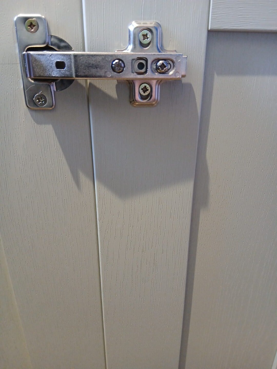

In your second picture, you can see that the screws are at the top of the slots on the right hand side - if you loosen those screws, raise the door and retighten, then the door will be higher.

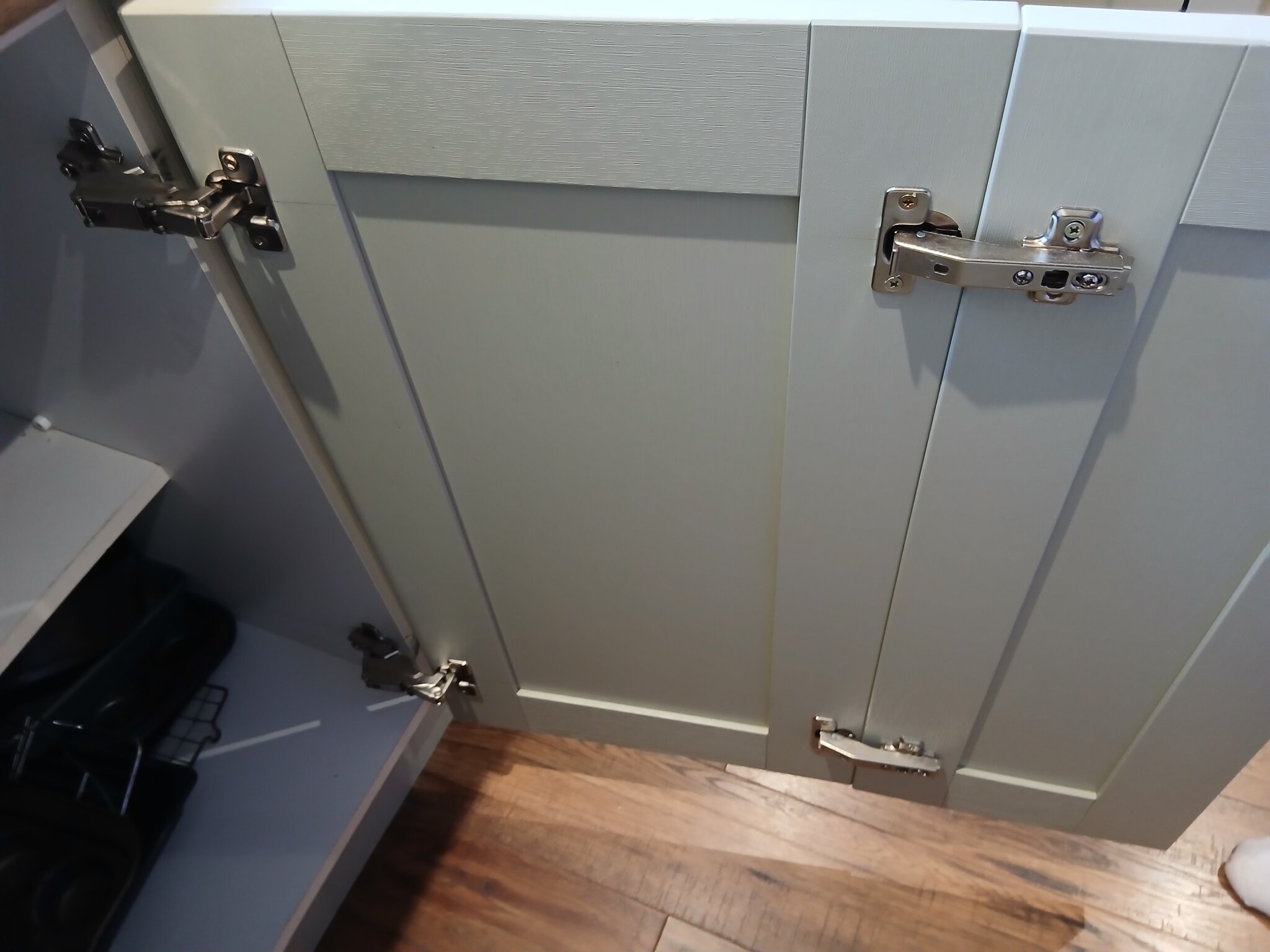

You might also adjust the hinges, using the adjustment screws, to increase the gap at the bottom hinge and reduce it at the top, on both sets of hinges, to change the angle of both doors.
