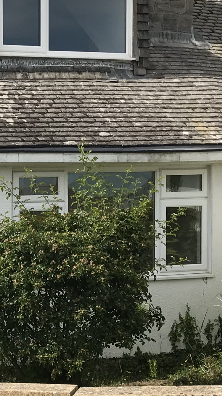

I have recently moved into a 1960s bungalow with a dormer. We started to get leaks in the living room after a couple of weeks of moving in. You can clearly see the history of botch jobs to hide the leaks and damage to the ceiling boards.
The finlock guttering sags outside the living room window near where the water accumulates and drips inside after significant rain fall. The finlock just holds a massive pool of water in heavy rain and I end up scooping it out manually. The reason I ask is that I have had the roof refelted and flashing, Battons etc done last week. This stopped a different leak in the living room next to the chimney brest.(2 leaks in total to start with).
Does finlock have the capacity to cause leaks like this? The guys who done the roof were surprised when I called!
Any help would be appreciated.
A few pics, one shows the sagging finlock where the guttering has no pitch and the water pools in heavy rain.
The other pics are the leak location and damage. The water droplets start to drop through one exit point in really
heavy rain, one drop every 20 to 30 secs
The top pic was done prior to the roof being sorted !
