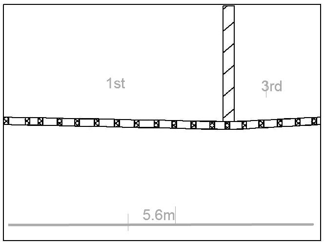

Hi,
My house was built in the mid 80's. The lounge is approx 5.6x4m and spans from front to rear of the house. Above this room are the 1st and 3rd bedrooms. The dividing wall for these two rooms is built of what I think is the thermolite blockwork. The weight of this wall seems to be making the ceiling sag in the lounge. When I walk in the 1st or 3rd bedroom there is a little floor bounce.
The dividing wall runs the same direction as the floor joist. See side view.
There looks to be some minor cracking in the walls below the lowermost joist...
So here's the point of the post:
Who can I get in to take a look at the issue?
Could I just take down the wall and put up something lighter (plaster board) wall instead?
Cheers,
M
It is quite normal to build 3" clinker block walls on floorboards. Looking at your drawing I would suspect that some ground floor walls have been removed. The floor joists would need to be at least 220x47 (9" x2") to span the 4 metres and I would be surprised it they are more than 7" x 2".

If the joists are 9 x 2 then they should be ok. If the neighbours have no sag then I suspect that one or more of your joists has failed. It will be necessary to carry out a proper inspection around the area of the wall to ascertain the problem.

You will need to find a good carpenter or builder, preferably by recommendation. They should be capable of suggesting a solution but I think it will be obvious if there is a failure. I would suggest that it would be advisable to put some temporary props under the joists under the wall. It's surprising how much plasterboard can carry when spanning joists.

At first glance, your case seems to suggest overloading of the joist immediately under the wall but I wouldn't feel sure this is the whole problem. The cracking in the walls at the ends of the joist might be cause for concern. It would be no good stiffening or replacing the joist if there is a problem in the wall at the bearings.
A surveyor, or an SE would probably be better able to advise than a builder.(Don't bother asking the Council's building inspector - they will only say 'get someone to look at it').
