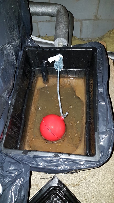

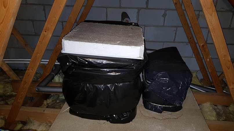

I phoned, and a chap asked me to check the cold water tank in the loft for any blockage. This is where it gets confusing for me.

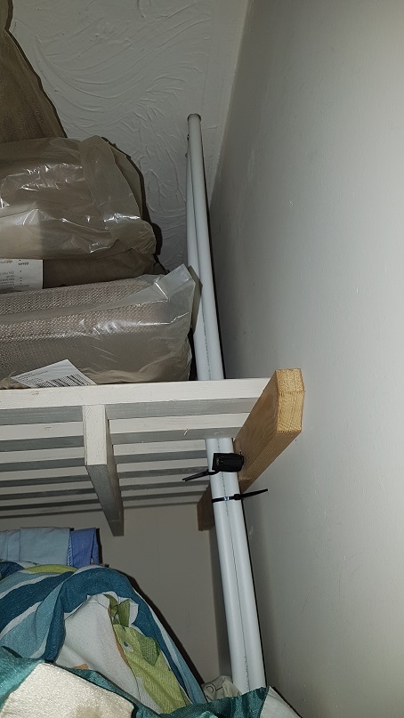

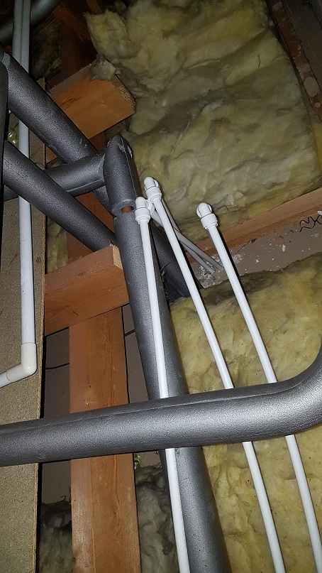

There are four pipes to the pump. I’m assuming this hot and cold in and hot and cold out. One pipe comes from my hot water cylinder and another leaves on the same side up into the attic, so that sorts that one out I think. Of the remaining two that go up to the attic I thought one would connect to the cold-water tank, however all three pipes go up into the attic and then towards the shower. None seem to connect to the tank. I also notice as I moved them sideways to have a look there a was a slight hissing sound at the 90 deg bend of the left one. Could this be letting air in?

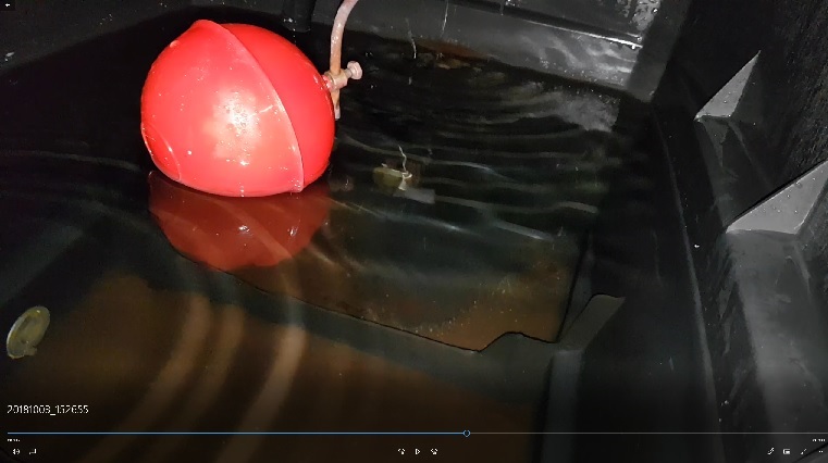

On top of this there are two tanks, a larger and a smaller one. I had a look inside and they don’t seem too clean, the small one is particularly bad. Could they do with flushing and cleaning? What is the smaller one for, I'm assuming CH expansion tank.? It looks quite empty.

One of the 3 attic pipes is the cold supply to pump, other two hot and cold to shower , double check its not connected to bottom of the big tank .if its not ,it could be mains cold ( which it shouldn't be ). The small tank is the f&e for central heating and its in need of cleaning , the level of water in that tank is normal to be quite low .
