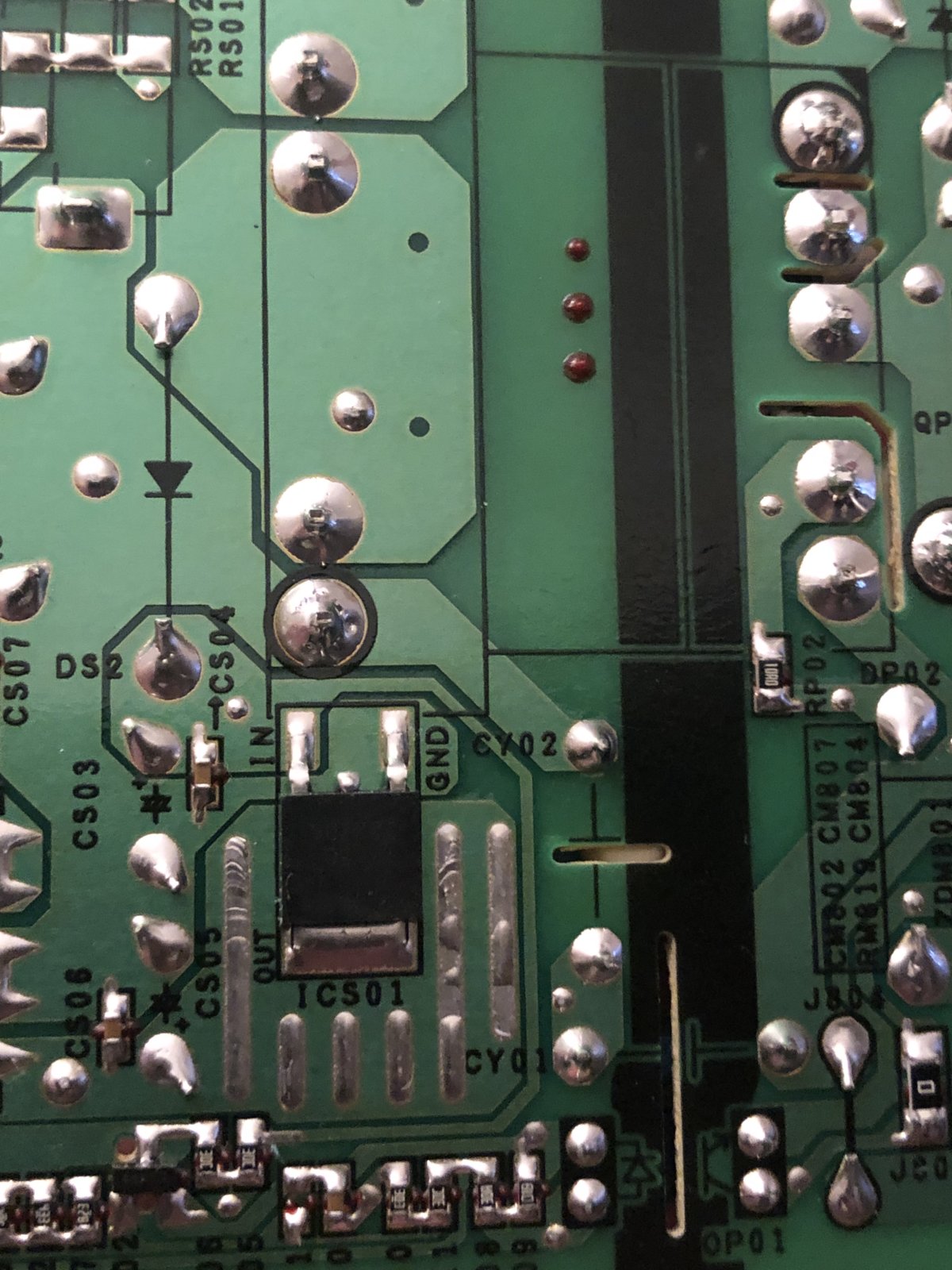

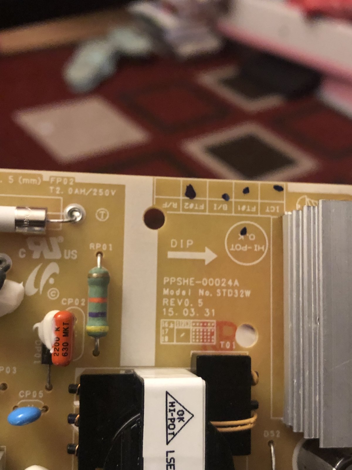

Hi I have an american fridge freezer model RS53K4400SA s/n 051x4ebha00993m bought from curry a couple of years ago. It has developed a fault No lights no display no chill freeze or water. If switched off for a short period I can hear something power up when switched back on all fuses are fine and the light (LMP1) on one of the pcbs lights for a second before going out.
Help appreciated

Hi again little update the power board number in first pic and a 5 volt reg in pic 2 ic501
There is a socket onboard with 12 and 5 volt the 12 is 10.6 and the 5 is 0v
The reg is measuring short between in and ground it’s been a while I cannot see a path for a short across the transformer
Anyone any advice circuits service manuals for this fridge
Cheers Dave
Well update fridge is working again whilst waiting for a new regulator i used a laptop psu and 2 variable regulator boards one at 5volt and one at 12 put wires into the lv plug and powered all on at the moment all is good
