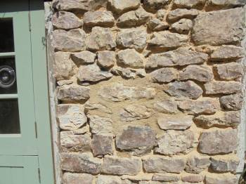

A lot depends on the type of sand they used/where it came from. Might be worth a test patch with red and yellow (if you can get it) building sand
Here's an example of a test patch I did for someone using a 50/50 Ginger/ Coarse washed sand and NHL 3.5 lime.
