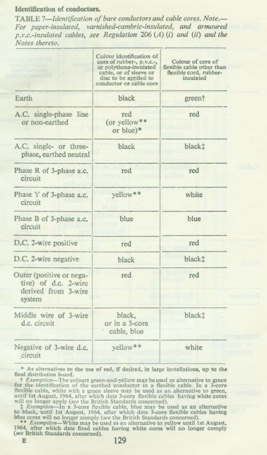

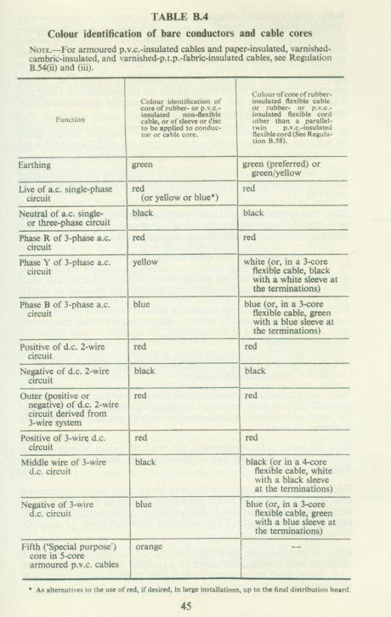

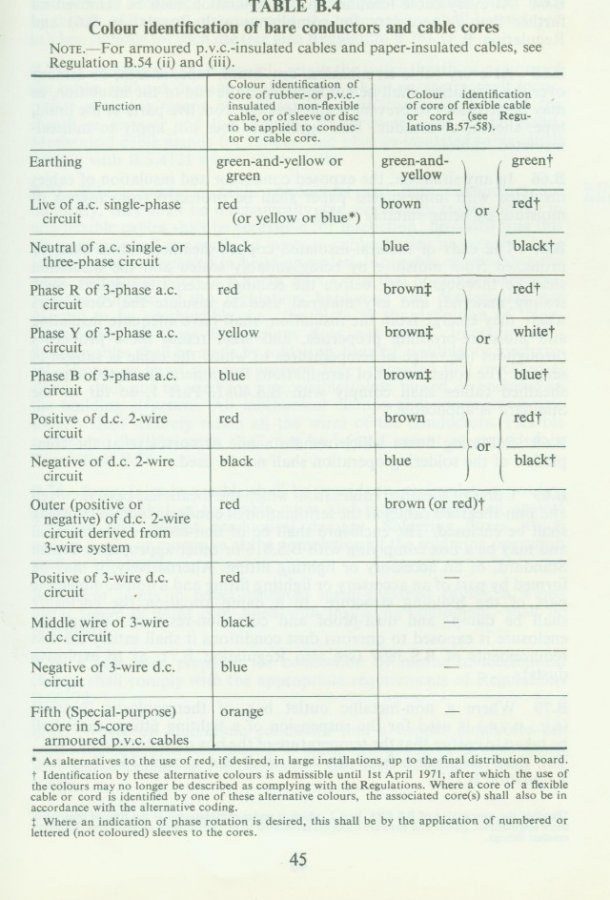

They used to be! Red, white and blue (how patriotic!) were permitted as standard colours for three phase supplies up until 1966.
Yes, I chose to write red/white/blue as many of the d.c. to a.c. conversions were carried out during that era, but some would have been done after white changed to yellow.
Not that the electricity boards necessarily followed immediately, but the change for installations in the IEE Regs. specified yellow after 1st August 1964. White continued to be permitted for flexible cords & cables to 1st April 1971.
From 13th edition as amended to 1963, original 14th edition 1966, and revised 14th edition 1970:
View attachment 91828 View attachment 91827 View attachment 91826

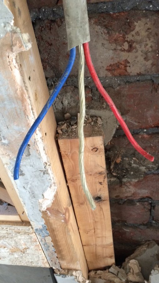

Also here's some RWB cable found on a recent job.
Interesting - Don't think I ever came across triple like that where the "white" core is actually transparent instead of opaque white.
