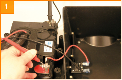

The darn thing works again, stripped to carry in flat, comes in 5 parts, rebuilt after opening main battery case to check overload fuses an battery, both 12.4 volt, rebuilt and all works, so not a clue why it stopped. Could be poor connection on one of the multi-connectors, or some thing resetting, but nothing in the instructions to say there is anything with auto resets.

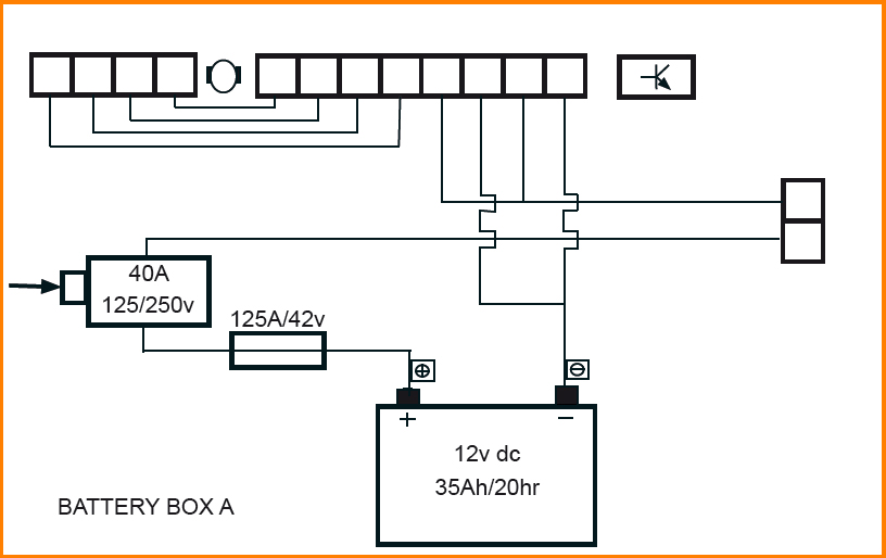

Not on the main supply, two 125 amp fuses, and a 40 amp trip. The 40 amp trip seems most likely, to be able to test I removed battery casing and the 40 amp trip from the casing, I had pressed the reset a few times yesterday, but maybe there was some strain on cables that stopped it resetting, but did not press it today.

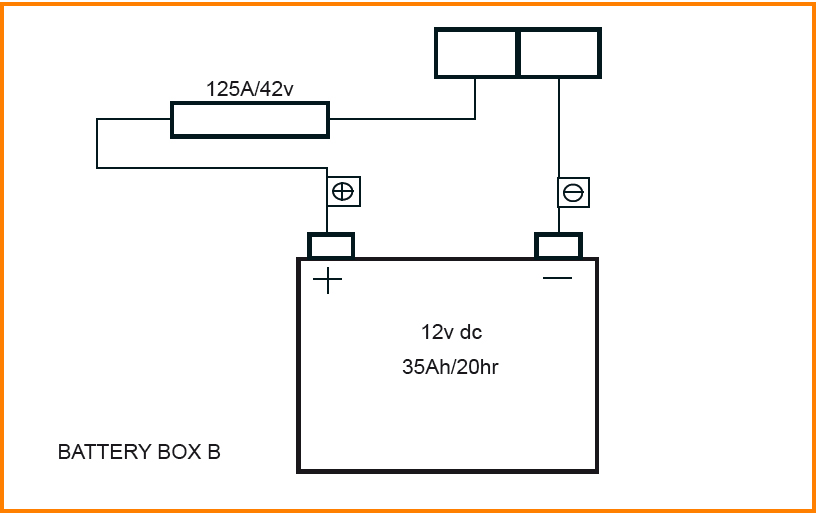

But it would if the 40A trip was in the main supply system. Since the batteries will be in series to provide a 24volt system a single thermal trip in any of the three/four battery lines will act as full system overload protection. 125A fuses in the individual battery circuits appears to be grossly over-rated. Are they original manufacturer fuses or replacements fitted by third parties. Do you have a wiring diagram that you can share.
Edit: Have just read the user manual and noted it states each battery has a 125A fuse so not an unauthorised 'up-rating'. I note the maximum slope specification is 10degrees so maybe just an overload trip.

Clearly no fuses ruptured as working again, as to if overload not sure is 40 amp and scooter rated 270 watt, so at 24 volt around 12 amp, so should not be anywhere near the current to cause it to trip, on another forum some one said he had a problem with multi-connectors on battery if pin not engaged, but since fault cured its self I have not a clue why it failed.

So took brake out of drive and started to push, after trying to reset overload, left ignition on so if it reconnected it would beep at me as brake removed. Last bit down 1 in 4 approx and with no brakes was not going to try, so took to top of house, and dismantle carrying down one part at a time, left until morning, then opened the battery case with over load in, as could not test battery assembled, found not fault 12.4 volt at battery, other battery also 12.4 volt so rebuilt, tested and all worked, so put on charge.

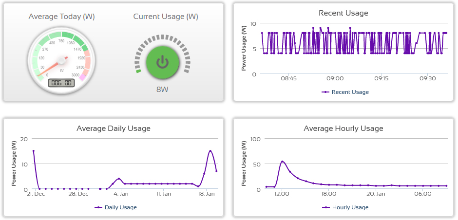

I actually monitored the charge rate ignore average daily usage that was kia car on charge before the scooter. It is still on charge at average of 6 watt, will take off charge tomorrow. I have always complained there is no way to charge batteries and leave the main part of scooter in the car, real pain having to have whole scooter built up to charge batteries.
I am starting to wonder about charging, I thought the charger could be left on 24/7 365 days without problem, and you unplugged only to use the scooter, however now day 3 on charge, and still taking an average of 6 watt, OK at 24 volt that is only 0.2 amp, but I had expected the charger to auto switch off.
