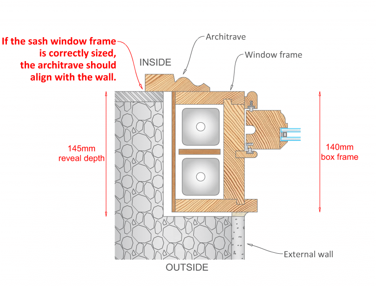

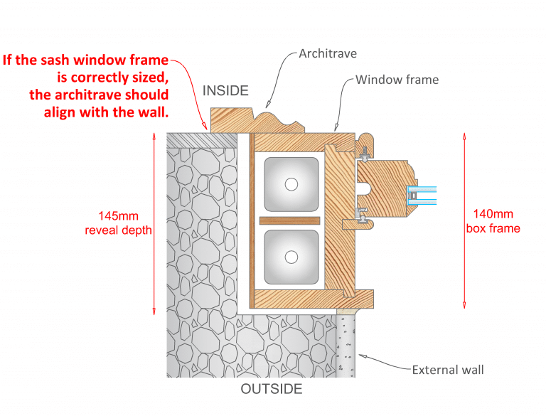

The reason why i'm looking at this, is when we built the new room a reveal was not added to the brick. I was assured with spirals the buildup would not be much. However compared to all my other sash windows below it, that have reveals, it is considerable and looks ugly in comparison. I'm also shocked by how ugly the non concealed spiral was - our bathroom below has a partial concealed spiral. I suspect a poor installation, with additional cladding has exasperated this. So I'm now exploring two options 1) see if a new install and product can match my existing windows on lower floors. 2) add a reveal in the brick, for the new window to be recessed into. If 2 is necessary, I could revert back to pulleys and weights, but I'm tempted to add the reveal and still add https://balancesystems.co, as long as I can re-assure myself it's the right choice. As this is what the bathroom below has reveal + partially concealed spiral.

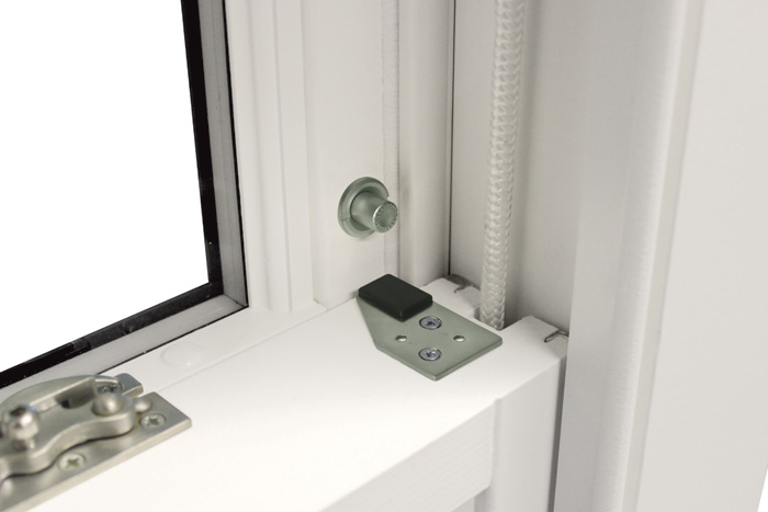

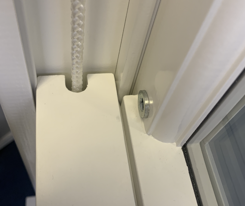

Mine is not pinnacle, but probably the preceding design. It is clipped into the frame, then the sash is slid onto it, and it travels up and down with the sash. You can't see it when in service. There is a groove in the side of the sash, and the plastic end cap at the top of the unit wedges into a matching plastic receptacle in the side of the sash.
A video will help you visualise it.
Have a look on YouTube for " how to remove and refit" for cleaning or maintenance.

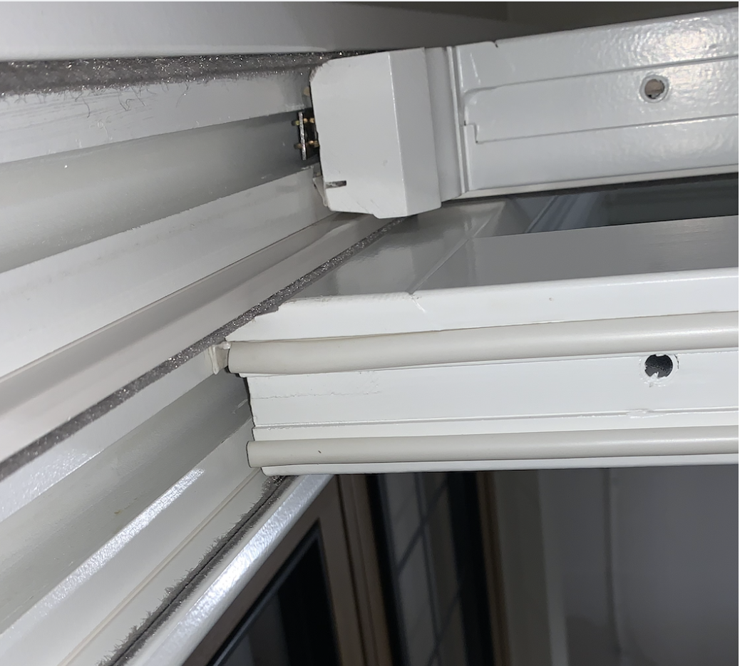

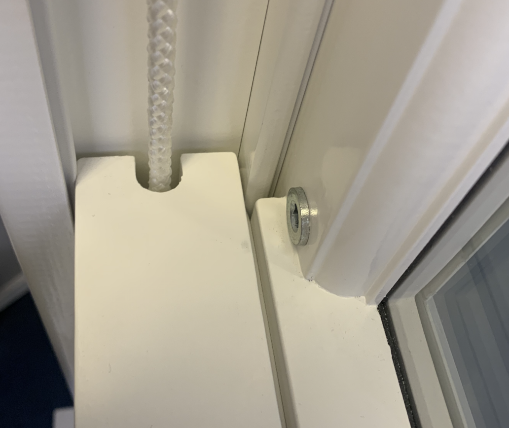

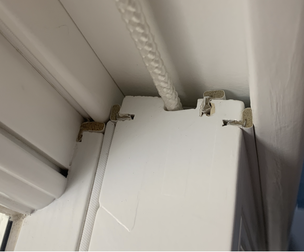

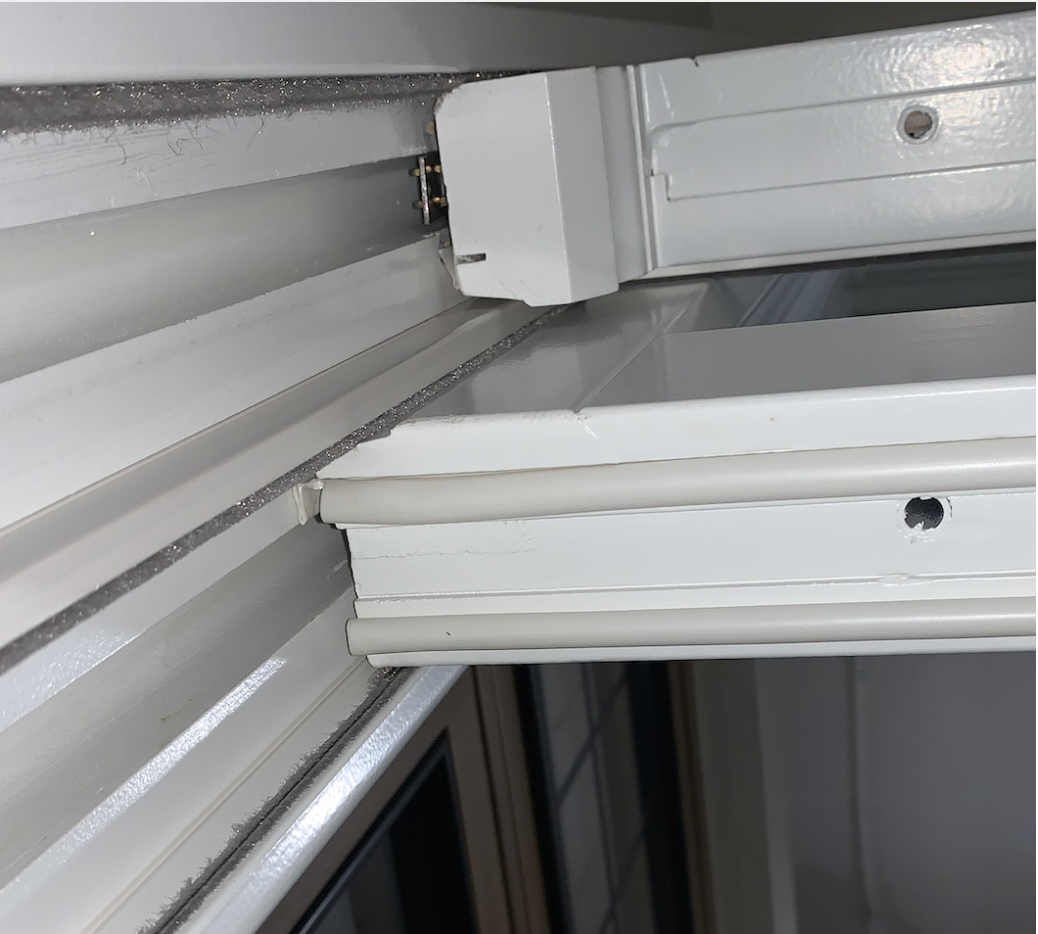

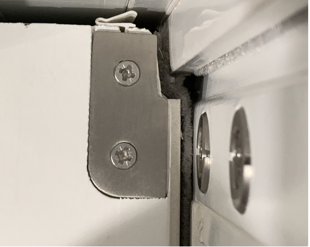

I had a quick look at the George Barnsdale CAD diagrams, looks nice. Wish I could see some close up photos. I have some from Mumford Wood and TimbaWood, see below. I must admit I have preference for the hard foam or nylon. My understanding is on new windows they seal better, with better acoustic performance and certainly less visible on the eye. If anyone is able to add any for George Barnsdale or Westbury, that would be appreciated.
mumford1.png timbawoodv2.png timbawoodv1_2.png timbawoodv1_1.png mumford2.png

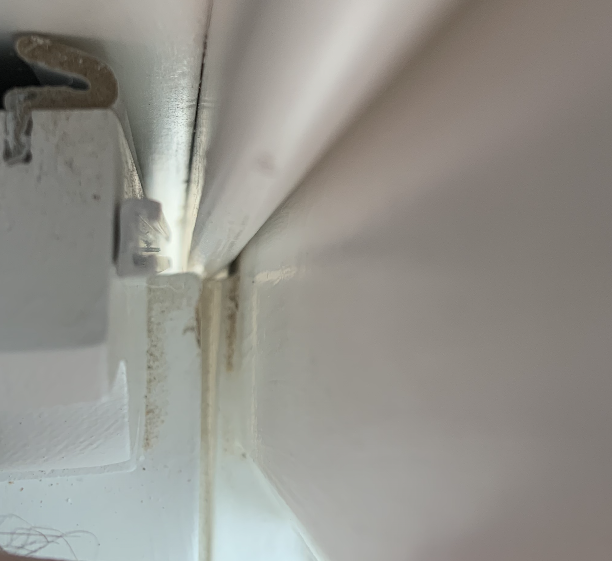

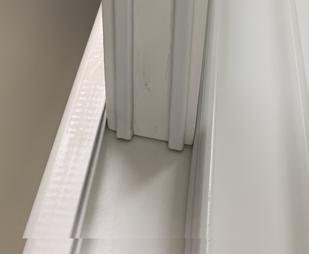

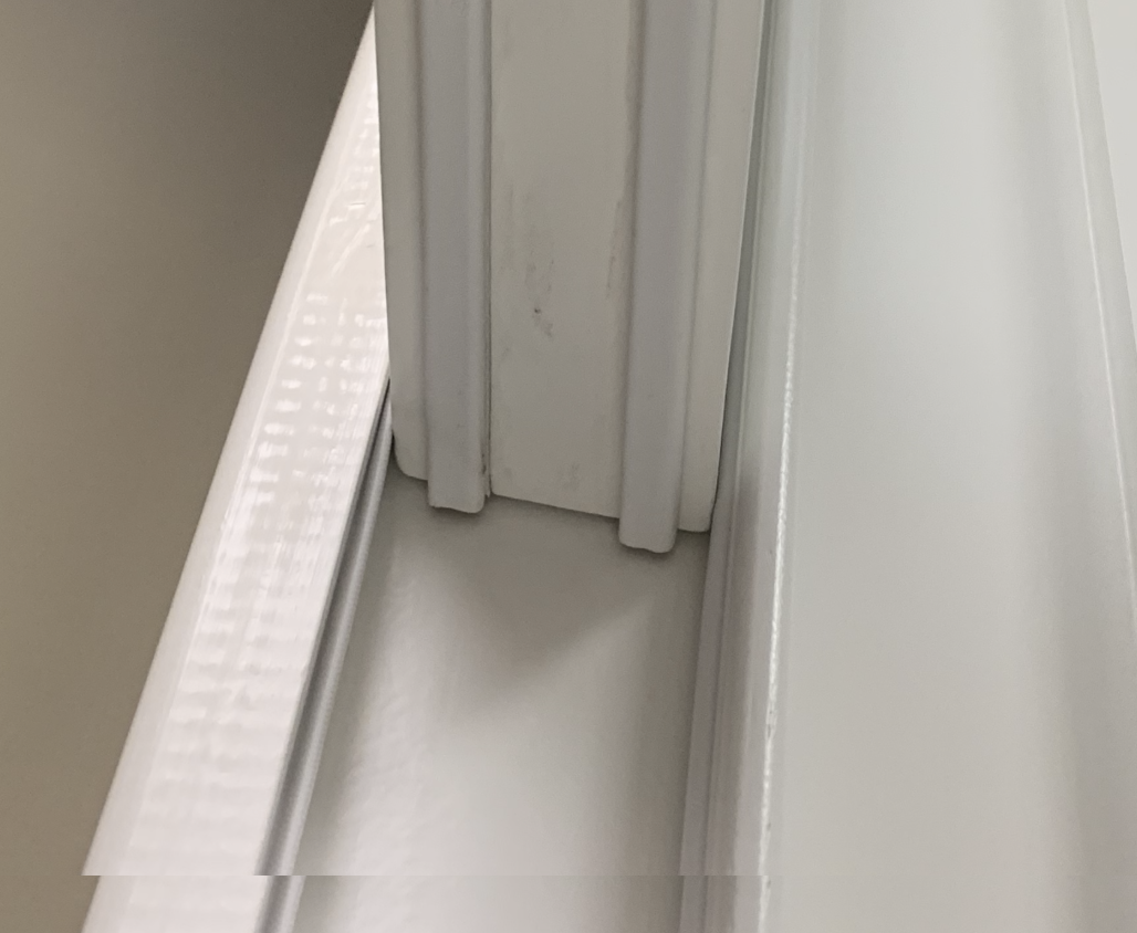

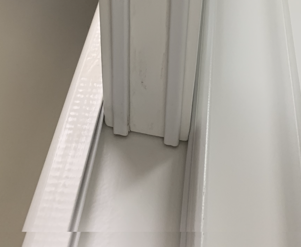

It's often hard to know what is a large reputable and what is not. Our builders picked a reputable local company, the build install was awful. The gaps around parting bead where nearly 1cm around the side and too with really bad draughts when windy. the window would rattle and bang as you moved it up and down. One of the spirals would "thwack" noise as it went up too. They had no weather seals on the parting bead, they came back to add those weather seals, but it clearly wasn't a correct install. They just stuck them on the window, but only to cover the meeting rail area, and not the full length of the parting bead, and then the piles started coming off. See image below, and that one had one of the smaller gaps. In the end they just refunded me. So I'm now looking to redo it all, properly.
Builders tend to use a local joiners they know, theres a "scratch my back" relationship.
The problem with small local joiners is that they don't specialise in windows and they haven't spent huge amounts of time and money on research and development to iron out all the complications that can occur in windows. With sliding box sash windows, there's the complications of weatherseal, parting bead, meeting rails, balancing. (I know, I used to own and run a local joinery shop employing half a dozen people).
Unfortunately it sounds like your windows had some design errors, with either the parting bead spacing or gap between sash and box frame incorrect. When using the furry stuff, I made box sashes with 3.5mm gap on the sides and 2.5mm gap between sash and outer facing and sash and parting bead.

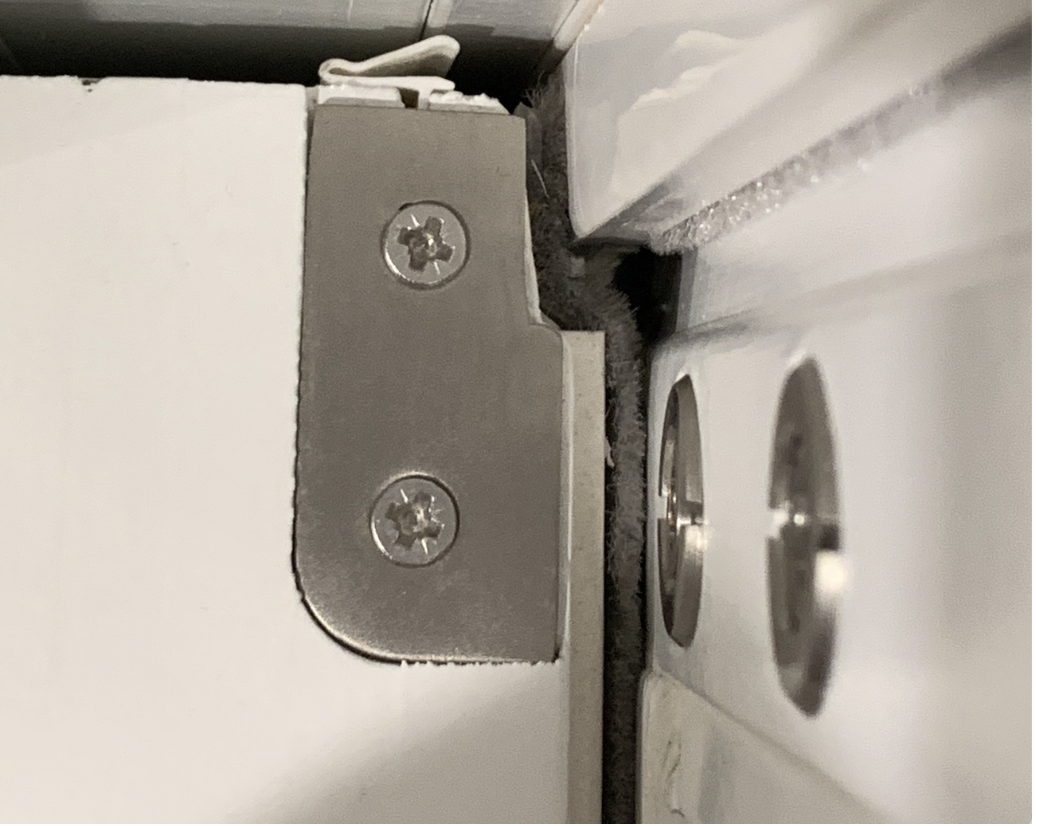

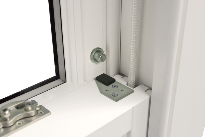

I looked over the George Barnsdale CAD diagrams and found a picture online. I can see the Aquamac 21 on the stile, but it looks like there is nothing on the parting bead, makes me wonder if the leaves a bigger opportunity for air exchange.
The TimbaWood instead places two nylon strips, one on the parting bead the other on the staff - so it's either side of the sash. And a third on the stile. Not the best photo, but you can see the two strips to either side.
I don't have he photo, but the diagram shows the one on the stile:
The Woodford and Westbury rely heavily on piles. From what I read the nylon/foam options of TimbaWood and George barnsdale should give a better seal. The three seal system of Timbawood, superficial, seems superior to the George Barnsdale one. So I'm tempted to go back to TimbaWood.
