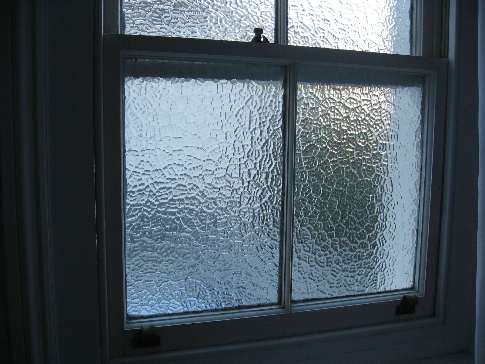

Hi, I'm considering ordering some slimline 14mm double glazing units and routing some sash windows to fit them in, however each sash has two panes, so routing out the middle bar ... well I think it might break ... not sure of the construction.
Is there a good way to do that ?
So can I just throw it away and use a single pane? is it structural and will the sash be weakened by its removal?
It's Victorian.
Cheers

you can buy stepped double glazing for this exact purpose or you used to be able too
you will need to alter the weighs or spring mechanism to accommodate the extra weight
The middle bar is an Astragal.
I have heard of them being routered to fit DG units, but have not seen it done personally.
I don’t think the sash will fall apart if you remove it, but again no personal experience.
Are you in a conservation area, and/or is this a listed building?
Have you checked to see how much weight will be added by the double glazing?
You may have problems sourcing new counterweights.

I guess you reduce the depth of the astragal, go for a single DG unit in each of the sashes and then make a fake profile for the outside and glue it on.
It might also be advisable to make arris type rails as glazing beads to hold the panels in place. Linseed putty is a no-no because the units cannot expand and contract.
You may be surprised how much weight you have to add. Many old sash windows had 3mm single glazing. If you go to 4mm DG @10kg/sqm each pane you will find you need 3kg+ each side to maintain balance. The problem is, with the small weight pockets, you may not have enough height. Also, if using corded weights, allow more than you think you'll need for cord stretch.

In the property there are 11 sash windows all with about the same height.
The ones I would replace (at the back) would be about 60% the width of the biggest one which sits in the middle of the living room bay.
Additionally I could use square weights so I guess its okay, but might add cost.
I was quoted £200 for replacement 4 6 4 slimline units per window plus delivery.
Low iron as well.
So it looks okay really. Router about £100.
But thanks I shall bear it in mind. 4mm is 10kg/m2 but 1mm on the other side.
But as I said the original weights are underweighted for some reason and the windows work.
Therefore I could just get make weights for the additional and see if it works.
exactly. If it's about 800x600 it's ~0.5sqm. = +5kg for one pane and + 1.25kg for the increase from 3mm to 4mm = 6.25kg or a bit over 3kg a side....
