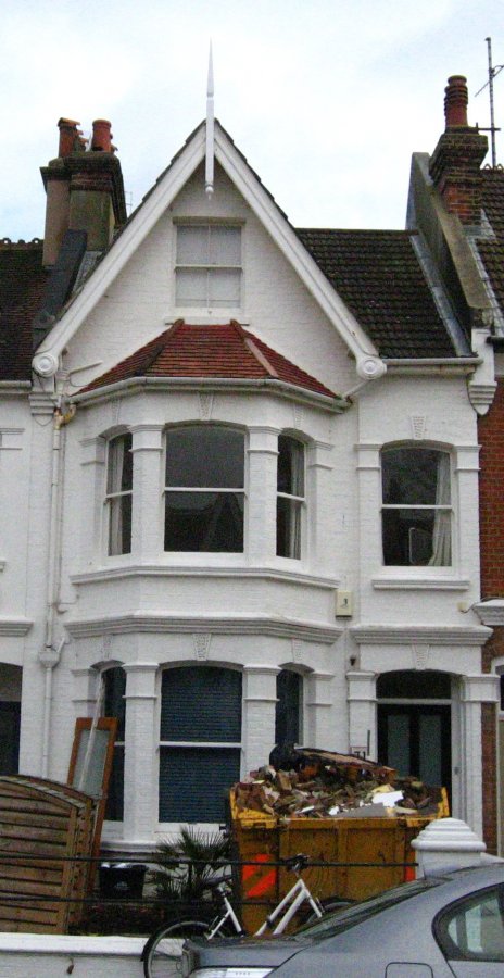

Are there any cheaper options for painting the front of the house without scaffold ? Is it possible to hire something, issue here is the bays push outwards making it difficult to paint the 3rd floor.
What would the cost be for scaffolding itself ?
Cheers
Could you hire a cheery picker for a day to do the top.
How many £'s have you been quoted for scaffold ?
Looks like a straight forward job,had a similar outside repaint and including scaffold last year,was £900 cash all in.West London area.
Get a few scaffold quotes or hire a tower.
have you got some ladders ?
It's a straightforward job, but at London prices, only a scaffolder can give you costs. It's on your land, so there are no council fees, and you might find someone flexible on their prices.

For a few reasons thats a scaffold job. A professionally erected & dismantled scaff.
Dont attempt to DIY fool around with a tower.
OP, there are a number of other remedial issues in your pic - if you want comment on them then just say so?

Sure what did you see?
Asked our usual scaffolder £400 for 3 weeks,you will have to provide adequate adjacent parking during erection/removal. Also think about correcting other faults while the scaffold is up,
OP,
The RH side of the roof is butted against a parapet, & looks to be "flashed" with S&C pointed-in tiles - lead flashing should have been used (like the LH parapet side) but if there are no leaking problems then fine, leave alone.
The RH fascia is showing water stains - the roof edge/fascia/ gutter might need looking at - esp at the outlet to the bay gutter.?
The LH side of the roof/dormer has a valley rainwater outlet (possibly, some kind of sheet lead detailing) into what seems like a 11/4" waste thats acting as a chute discharging into rusting down pipe fittings- this arrangement might be worth checking out?
Coming from the front bedroom & the dormer there are two waste pipes discharging into two hoppers.
Are there a couple of fixtures (basins?) still in use?
Wood barge boards should be probed for rot - the RH trim has peeling paint.
The facade looks to be in terrific condition for its age &, except for inappropriately painting it white, the elevation is original - even the garden wall & gate post(s?).
Perhaps, pre WW2 there were black painted iron railings on the garden wall?
