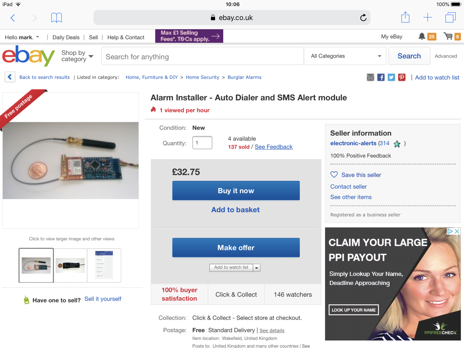

93EA16D2-68F1-402B-84E1-8E5A4E4584B3.png Alert electrical....looking at £100-200 depending on what your after or ...have heard some good things on this unit for the price ....text only ...
Thanks Sparkymarka, I take it the 4 wires can be screwed to the unit as opposed to soldering?
Does this just use the home WiFi?
Has anyone installed one of the Alarm Alert SIM card jobbies, are they easy enough to do??

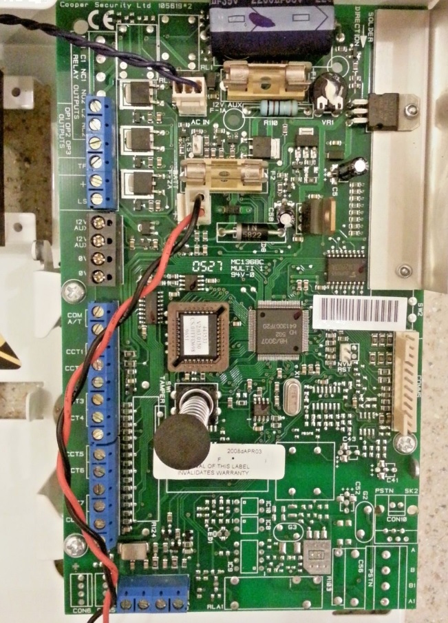

can anyone advise where I connect the wires to in the attached picture please?
Either to the outputs on the left
One spare for set op3
Use other op for bell
OR
Connect with the digi pins on the right ( panel comes with a plug on lead )
Thanks Sparkymarka

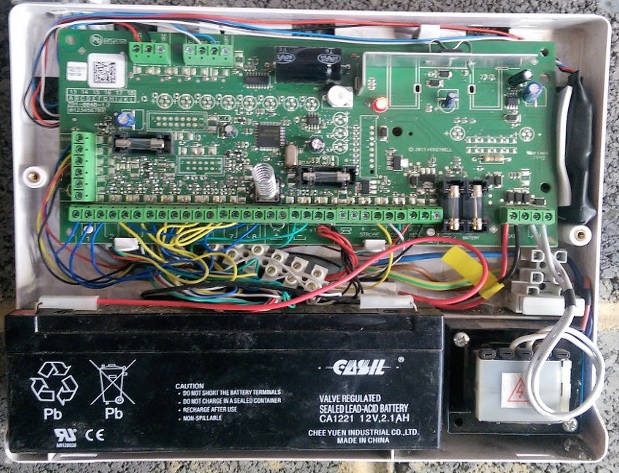

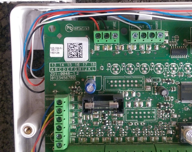

Would it be possible to highlight as I a complete novice at this, I have attached the item installed in another control panel if that helps??
If I were you mate I’d consider upgrading your system to a Pyronix Enforcer or Euro panel that has the App.
You maybe throwing good money after bad going down the 9651 route.
would it be possible upgrade to Pyronix Enforcer or Euro panel keeping the wires, PIRs and chime ? (so changing just the metal box and the keypad)
thanks
