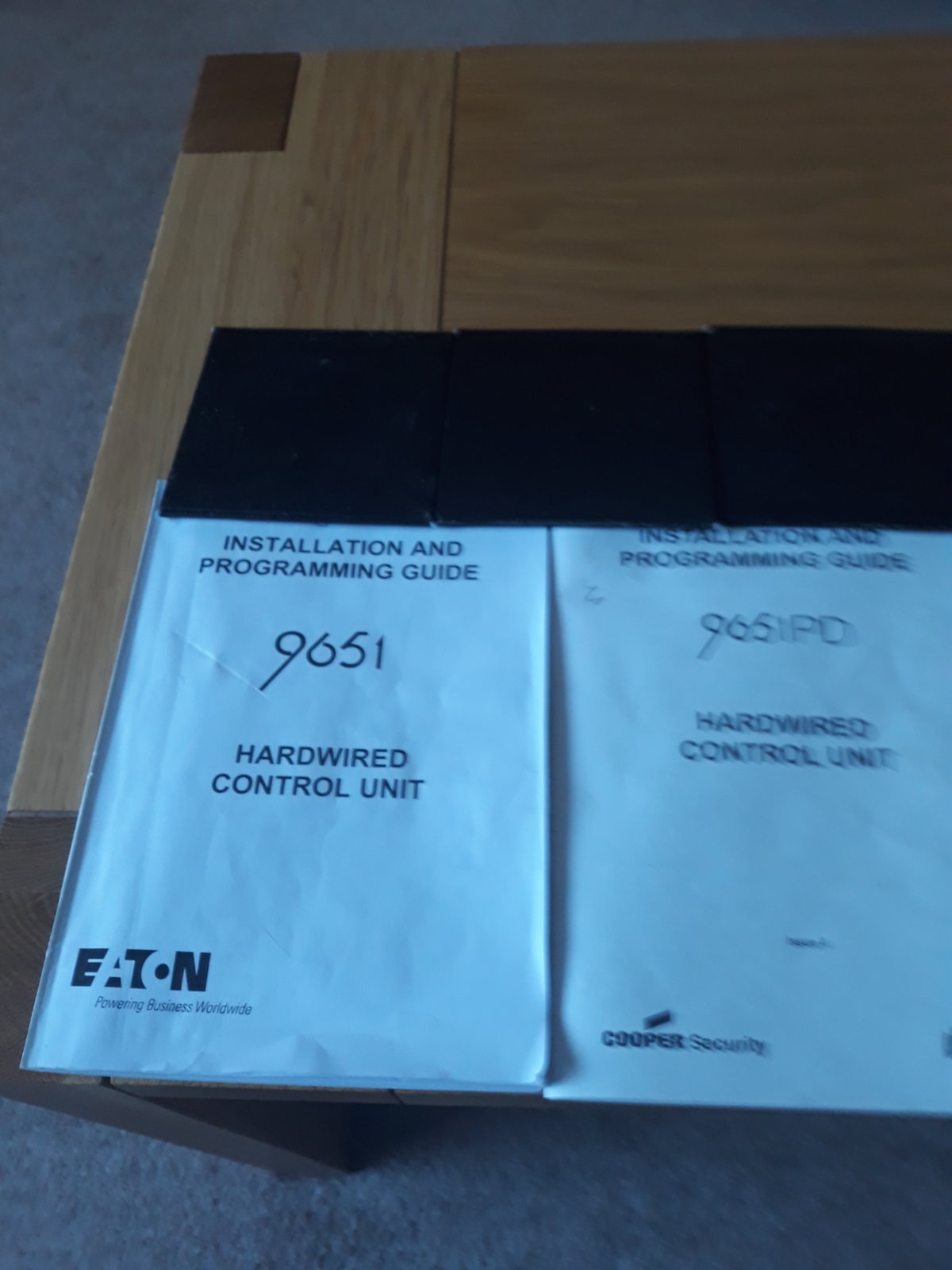

I have fitted several of these panels normally Cooper products,but today have fitted one
supplied by Eaton I there is no command number to program an entry time delay
in the installation guide for level A.
This panel is provided by the EATON group now not Cooper Security.

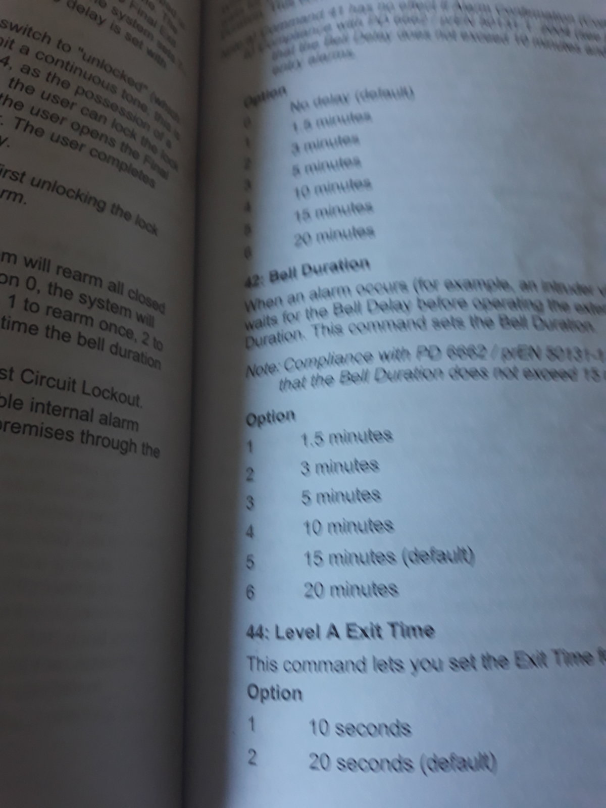

In the Eaton instructions there is a command 44 to enter an exit delay but know entry delay.

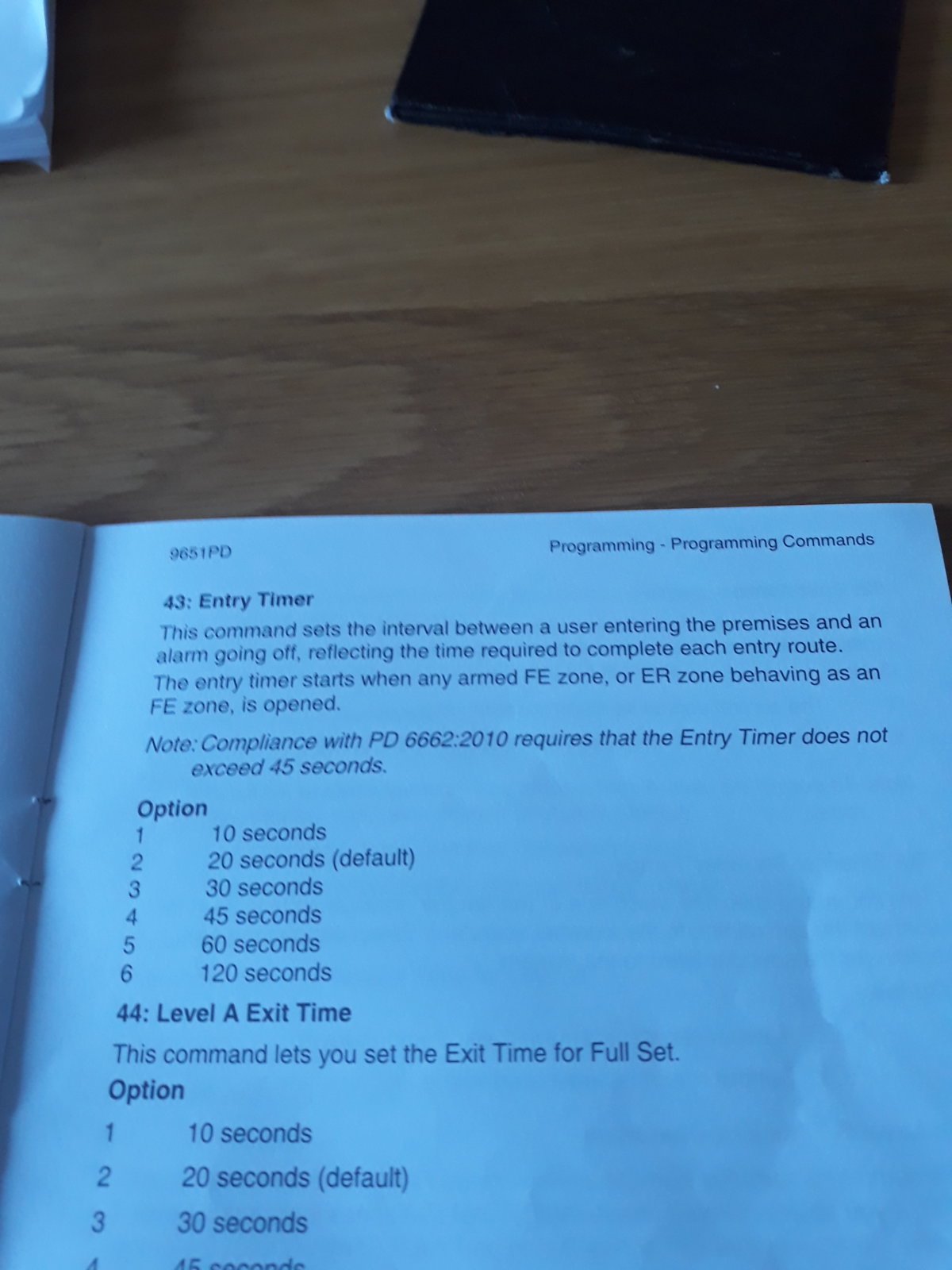

In the previous installation manual by Cooper Security it was command 43 entry timer.
Has this been omitted by mistake and has anyone experienced this in Eaton manual or been able to enter a entry delay time on Level A.

Hi I`m a Sparks and from time to time asked to install an alarm, I normally use 9561 with 9943 key pad.I normally use command 43 Entry Timer to set the entry delay to 20 or 30 seconds depending on installation.
On the latest panel (provided by Eaton) in the installation and programming guide command 43 no longer exists.

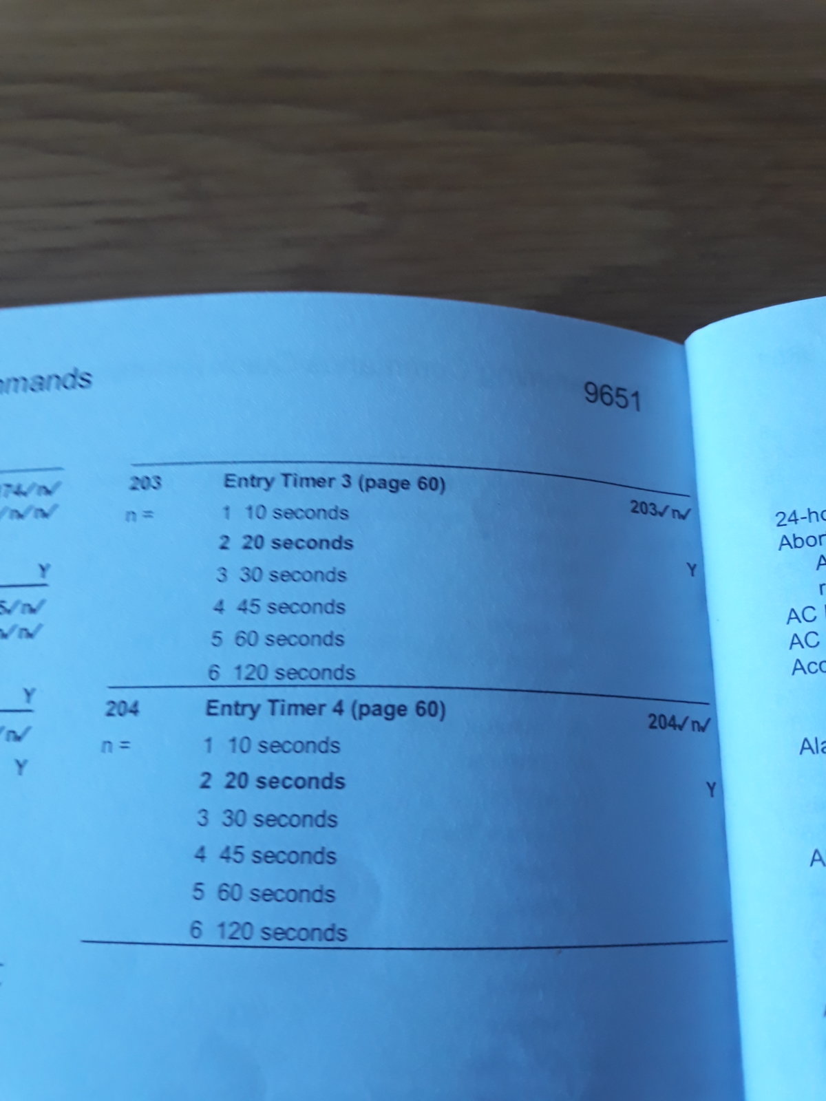

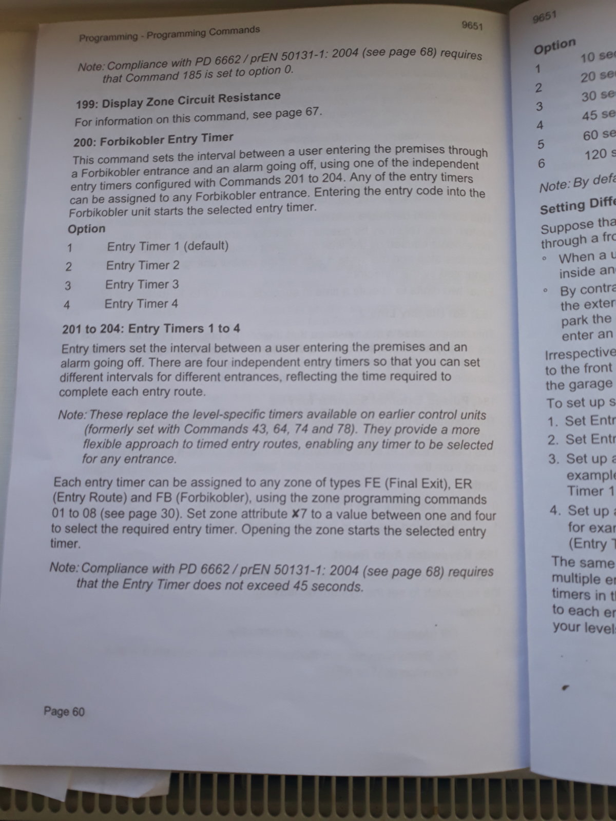

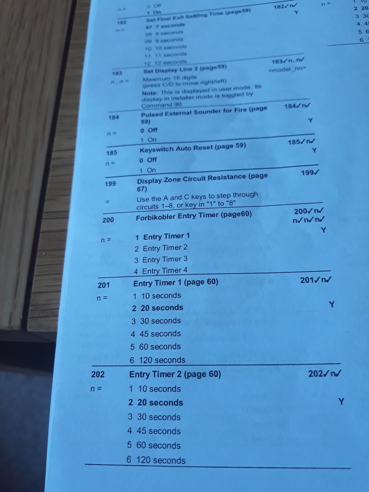

I think I have sorted it out as there are now new commands 201,202,203 & 204 all titled entry timers, I think they are related to ZONES 1-4 in order to allow different entry routes say from an internal garage and putting an entry time on a different route.The instalation manual has increased from 52 to 80 pages.
The 1st 2 are from old manual, 3rd picture shows command 43 removed and the last 2 show the new commands

Pages 60 & 61 from latest installation guide,
The main exit/entry route on level A and enter on command 201.
I think I need to use commands 201,202, 203,& 204,it looks to me that this the way to enter a entry time delay, do you think I am right.
Level B,C,D 202 or 203 and 204 to allow a part set options (upstairs omitted)
It’s saying x7 in attributes then 1-4 for entry time for final exit zones ....eg zone 1 was front door , select x7-1 ( eg 20s)
Zone 2 was garage door , select x7-4 ( eg 40s) more time needed
