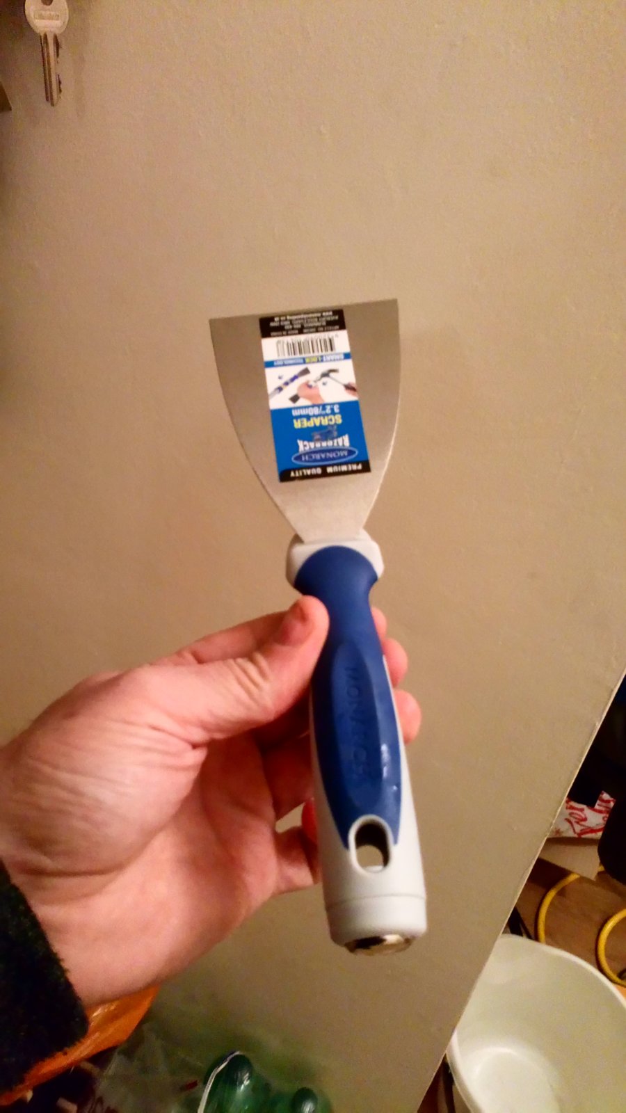

A friend used it to get a door stop out, so we could move it back so door fitted. It's like a scraper but you can hit it with a hammer. Anyone got a link to buy it?

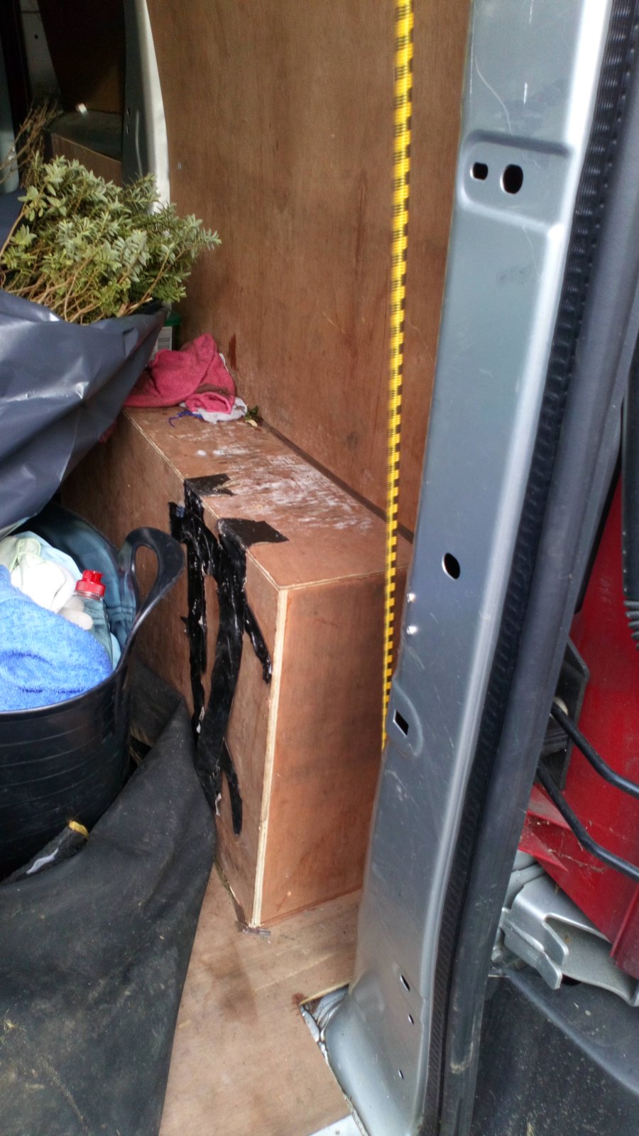

Wondering if it would work on my ply lining, to get it apart it's nailed together I think.
Yeah, but this tool looked like a paint scrapper but you hit it with a hammer. A chippy on here must know what I mean?

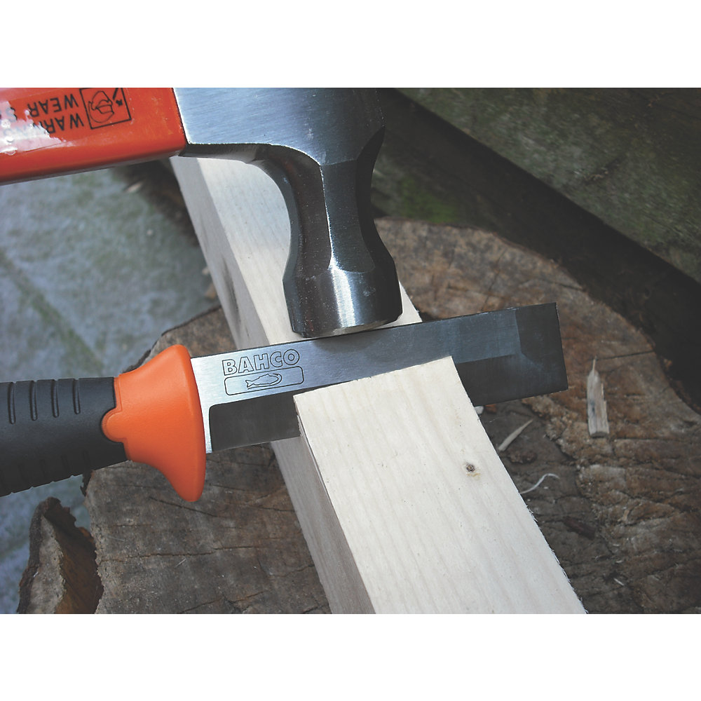

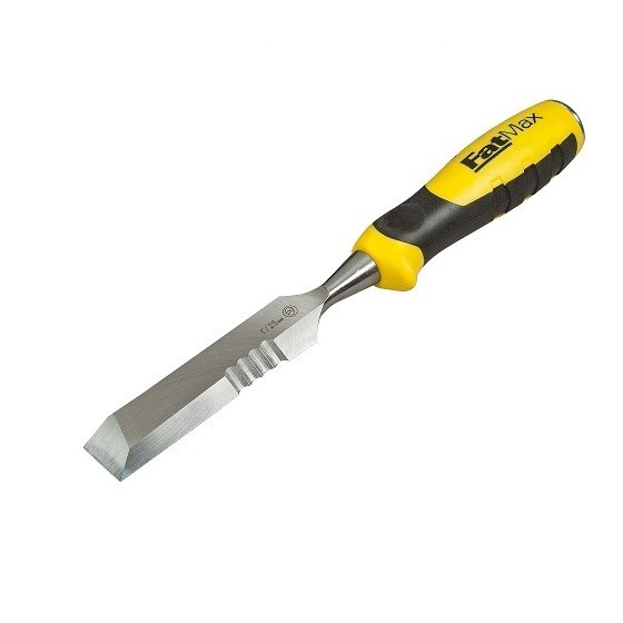

Modern tools could be the wrecking knife (Bahco) or demolition chisel (Stanley Fat Max). A mate had the Bahco - destroyed it in about a week (it shattered when hit with a hammer once too often). Seen a similar thing with the Stanley - snapped in two when hit too hard. Those Stanley ones are also a bugger to sharpen (weird blade cross section so they can't be held in a honing jig and they don't sit right on a grinder tool support - I had one and gave up on it after a while) - and the nature of the beast means that you end up grinding chips out of the edges of these things a lot.
Above: Bahco wrecking knife
Below: Stanley Fat Max wrecking chisel

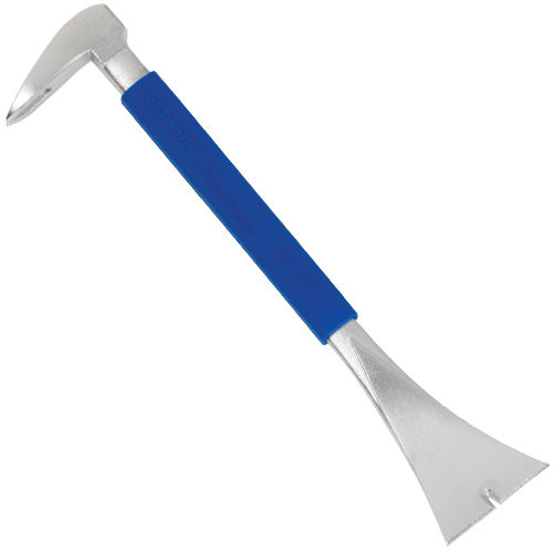

In the end I went back to what another posted suggested - a broad chisel (38mm or 1-1/2in). I've always carried two or three old chisels in various sizes picked up over the years for the rough, dirty stuff. Works well for me. The only other things I use for dealing with stop laths, mouldings, etc are a couple of small pry bars - a moulding pry bar (Estwing) and a 15in bent steel flat bar. These moulding bars (sometimes sold as Japanese reform bars) come in 10in and 12in sizes and can be ground to a chisel edge if needs be (waste of time IMHO) - other firms like Stanley do 8in and even 6in versions although I find them too small to get enough leverage. Even with those the 1-1/2in chisel is used first to start the splitting. The secret is use it bevel down to the flat surface and to keep it sharp

It's a freakin chisel - why not just buy a set? Then you can find out what they are capable of

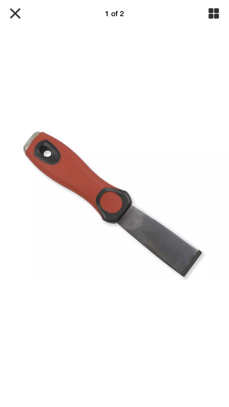

Just got it and it isn't as wide or scrapper like bit I guess I can separate wood with it
One thing I will say about that - it won't take many whacks with a hammer before it disintegrates. Only saying
