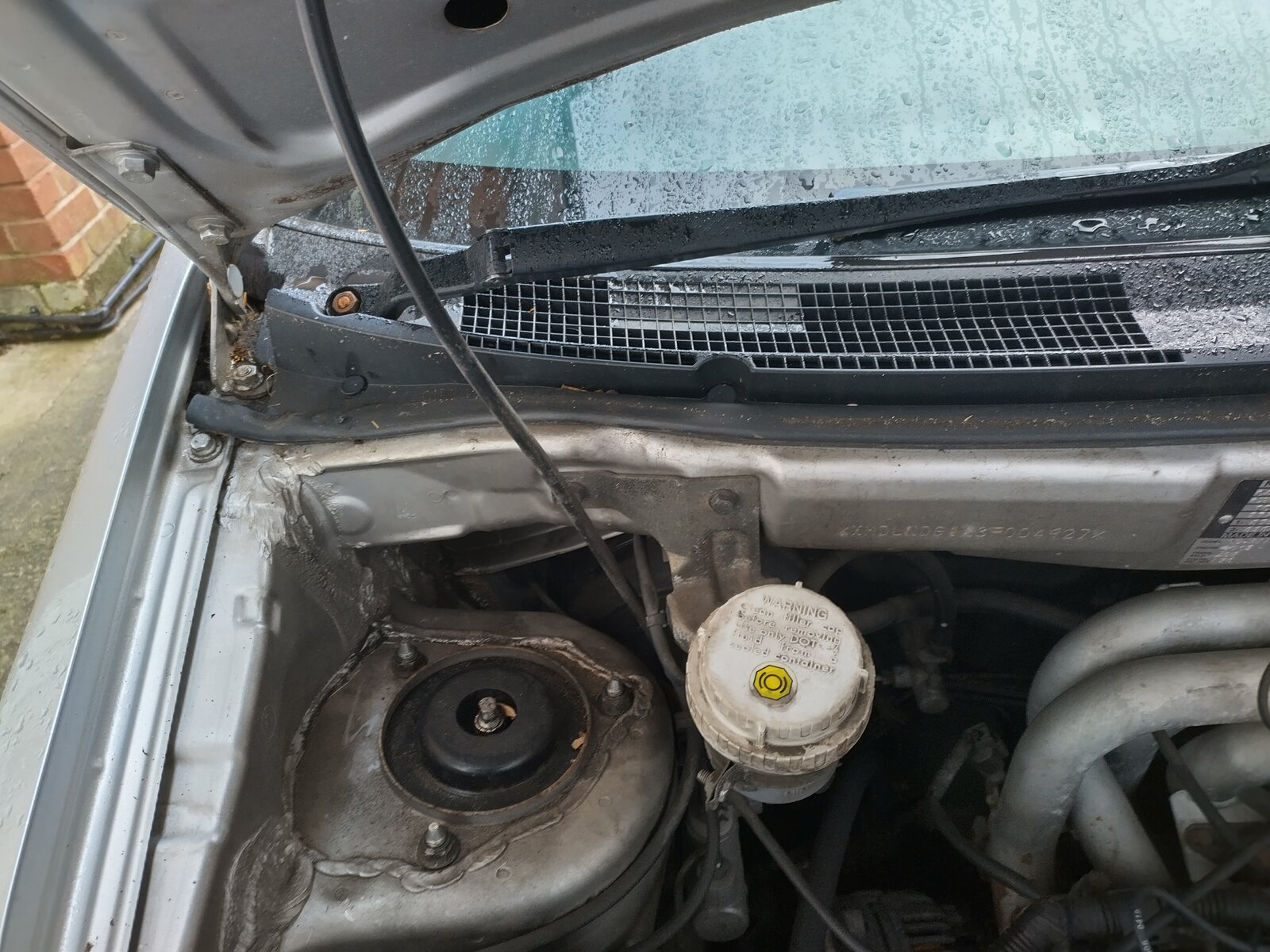

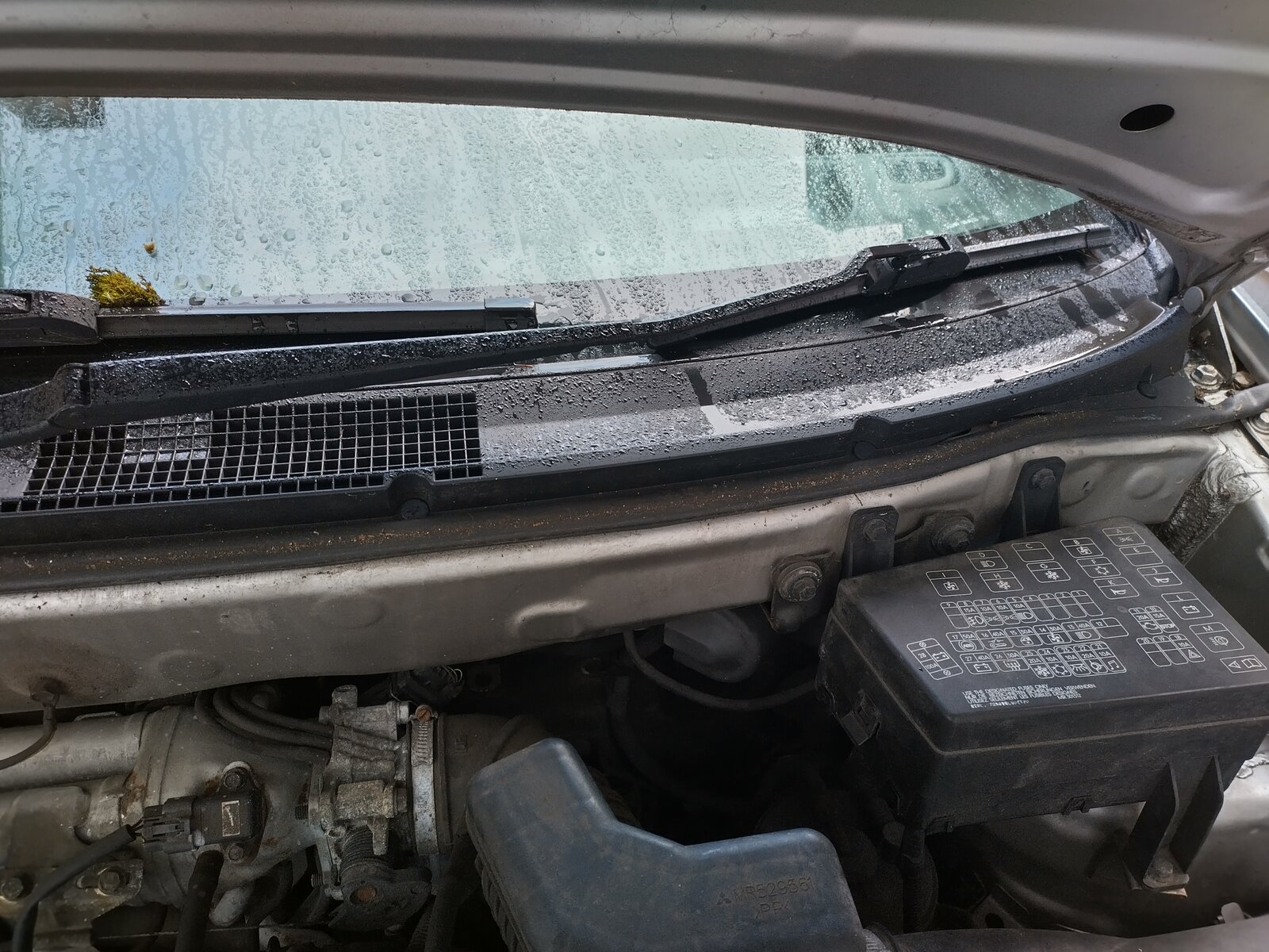

There's the box where the wiper gubbins is located.
I'll have to remove the wiper arms and the black panel to look inside, but whether unblocking it will get me a better price, I'm not sure!
Looks like I'll need a pry tool and some replacement trim clips too.
So today I took the wiper arms off and removed the black plastic panel.
But I'm burgered if I can find any drainage channels or pipes, let alone a blockage!
I put a folded dust sheet into the driver's footwell and poured water into the box section. I could see it appearing under the car, but none appeared in the footwell.
I looked as best I could and could not see any routes the water would take.
I came to the conclusion that perhaps the exit route for the water was frozen up.
So I put the car back together and I'm searching online for the best price for it.
