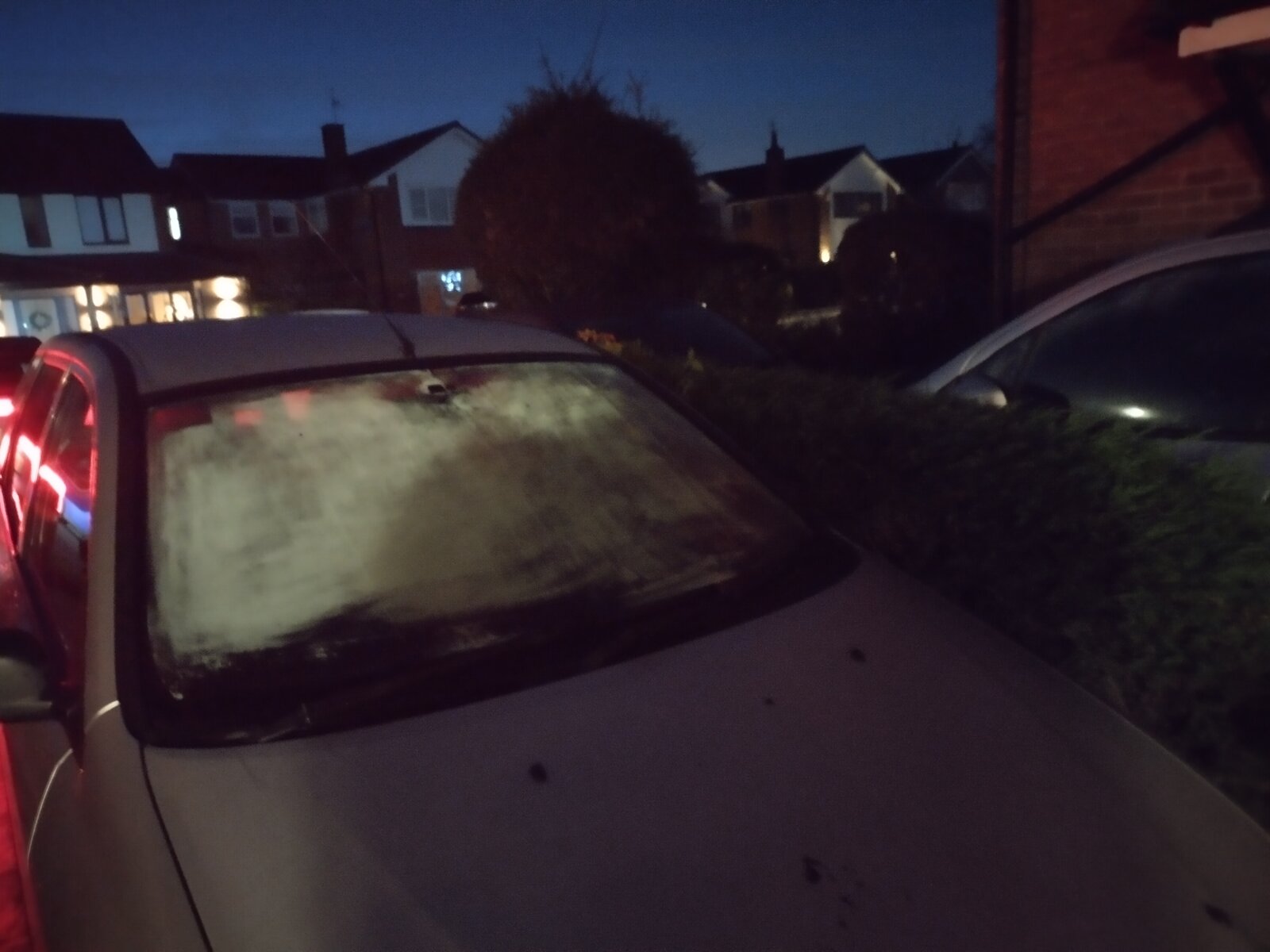

This is the windscreen tonight. The rest of the windows are relatively clear. I think there may be a leak somewhere. I'm not sure about investing in coolant which may well end up on the driveway!
Might fill it with water and see what happens. If it holds, I'll have to drain down and use coolant.
Have you ensured that the windscreen (inner surface) is clean, and free of grease / road gunk etc?
My car has been very foggy recently, and a good clean of the inside of the windows, followed with a thorough wiping with meths, had made a big difference.

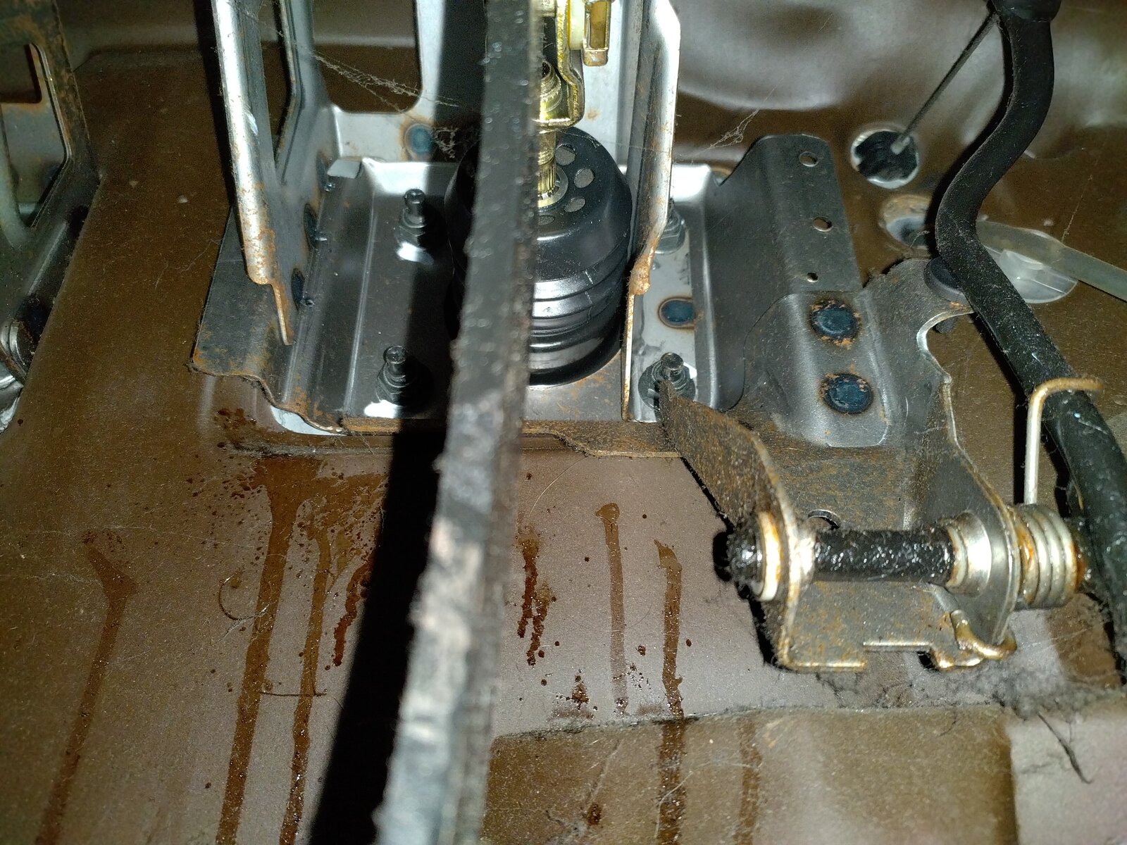

I did get a piccy looking up from the pedals and there seems to be something dripping down. God knows where it's coming from, but I have double-checked and the stuff wetting the carpet is plain water. There is no smell to it and it has the feel and consistency of water.
Leak from the plenum chamber I would suspect....
Under the bonnet, between the engine compartment, and the cabin, there are usually two panels, forming a sort of box, below the windscreen. The bottom of the box will have drains in each corner, to allow rain which gets in, to escape and drain away. Leaves and other debris can block the drains, hence the compartment fills with water, which has to overflow somewhere.
Is there a scuttle area under the bonnet, behind rubber strip, under plastic trim.
Is it full of water, or some water in there? Any drain tubes or holes (often rubber tubes) they get blocked easily and water feeds backwards into the car
