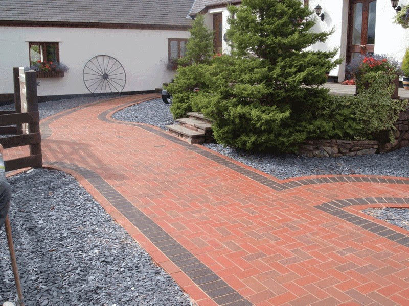

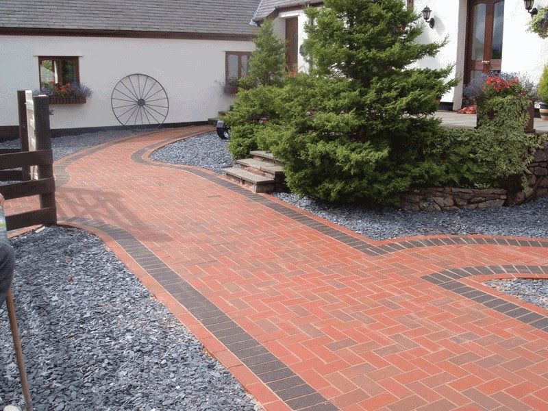

As an aside, does anyone know if these are Red pavers or Brindle, I would have said Brindle but they look too red to me
