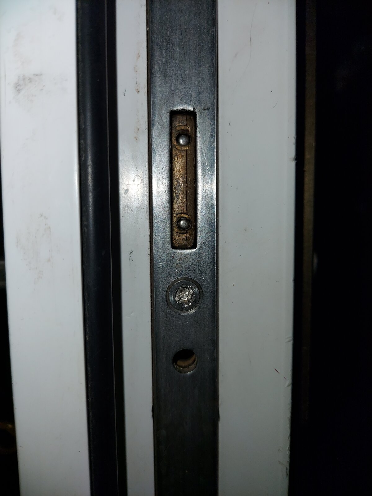

Screw Stuck - head chewed up

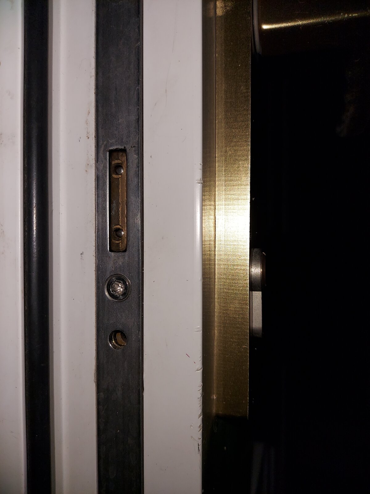

Hi
I have tried using a rubber band and the drill on a slow setting (reverse) but I still cant get the screw out.
Just wondering if there is anything else I can try before calling in the pro's?
Many thanks
Chip it round with a sharp centre punch. You only need to be able to loosen it, maybe 1/4 of a turn.
I would if I had a centre punch. I will add this to my list of wants. Thanks. Locksmith coming out tomorrow.
flat screwdriver about 2/3ds the star width tapped in
check you are using the correct driver as in pozi is a star within a star both screwhead and screw and Philips a star and different point angle
Have you been using a cordless screwdriver/drill and running it clockwise instead of anti-clockwise?
As Stivino says, a 1/4 turn anti-clockwise will have that screw loose enough to spin out using the end of your finger if you wanted to.
Even a tiny (3mm) wood chisel can be worth sacrificing...sharp enough just to dig in at the edge and spin the screw.
John :)
Hi
Many thanks
You have probably been using the wrong bit, it’s Phillips head, a posidrive will damage it.
a small left handed drill will usually help you get those out, if it starts sticking to the metal of the screw, then the screw will unwind out for you
