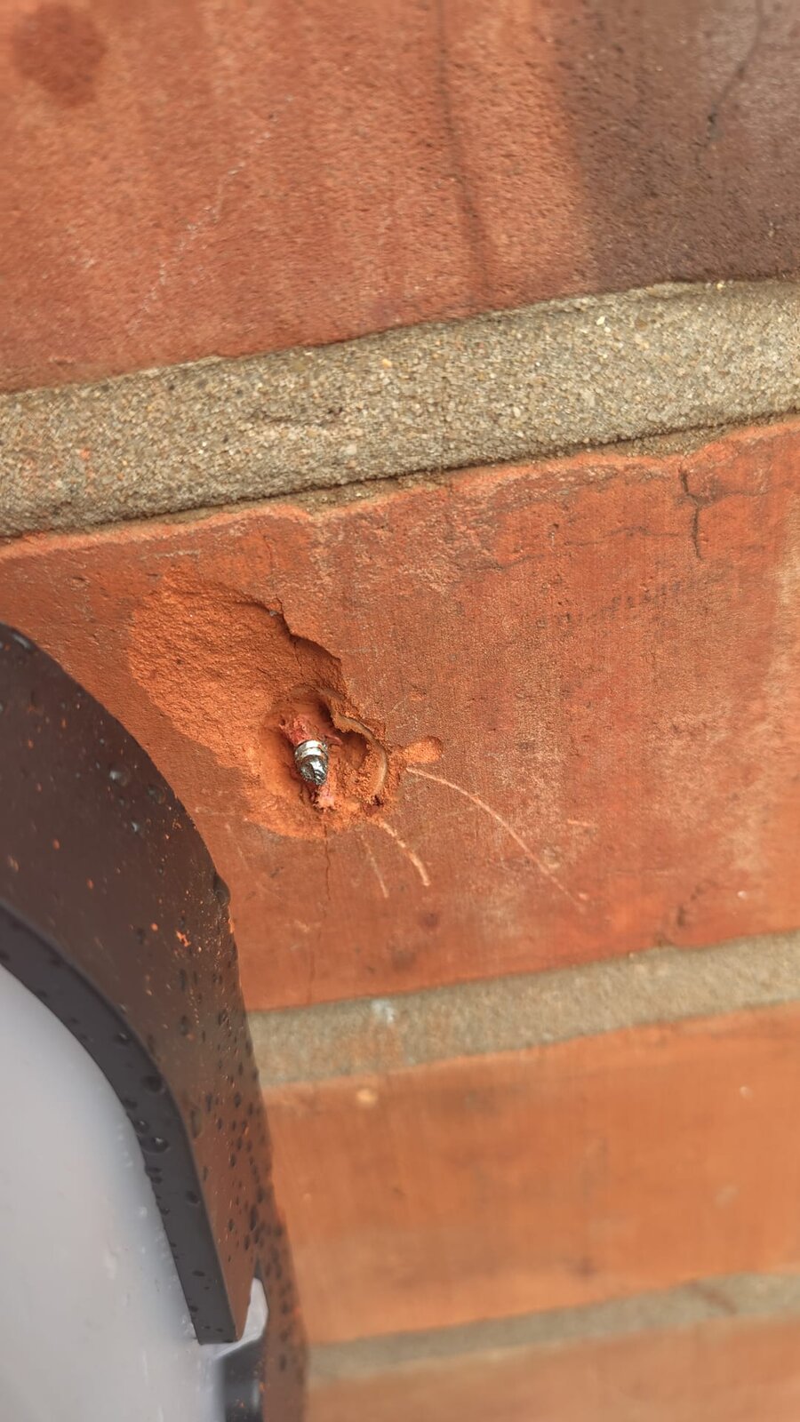

I am fitting an external light outside my house. The good news is the light works. The bad news is that one of the screws (wood screw I think) is broken and stuck in its raw plug and snapped off in the wall.
It's not easy to re drill a new hole.
I am not sure how I am suppose to get the broken screw out the wall?
Also these are engineering bricks they are an absolute nightmare.

I dont know what tools you have but I would grind it off with an angle grinder and then mount in a slightly diff position but covering the brick damage
ideally use an SDS drill or if using a conventional combi cordless, then start with a 4mm hole and work up
if you used a concrete screw, I would use a conventional screw and a plug next time
concrete screws are very fussy on size, on hard brick they can jamb and on soft brick they wont grip -on engineering brick you need a 6.5mm drill bit probably

Yes I was thinking it might be best to drill a few hole, I have bought a a new SDS drill recently but will need to get some drill bits for it.
Unless I can use standard drill bits with it?
I'm not sure what type of screw it was maybe a wood screw in a rawplug.
Will have another go tomorrow.
Oof, you've tried the obligatory mole grips? Did you mean to write masonry screw?
I'm not 100% what type of screw it is , just one that came in the packet and I used a rawplug. I have tried mole grips but can't get them to grip.
I am using some cheap pliers now, but its hard to tell if the screw is actually turning.
If you can’t unscrew it with a pair of pincers or pliers, use a screw extractor, they use a reverse thread so you can extract the screw effficiently.
