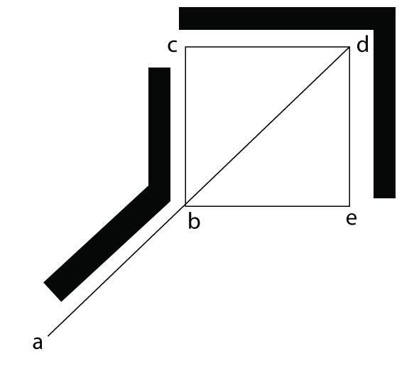

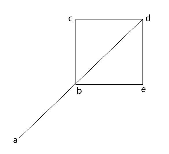

Now, if my earlier suggestion won't work hows-about copying the external angle using the abc in the diagram below (or abe)? Presumably you're using cde to copy internal angles. It's all about the geometry of the parallelogram bcde & it's (not the wall's) internal & external angles.

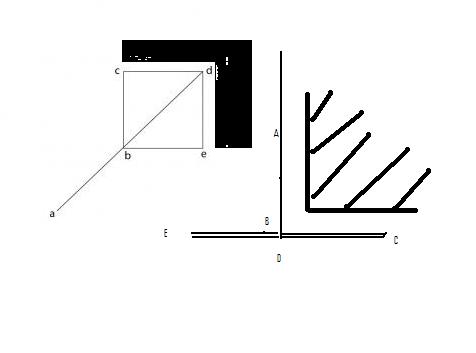

Does it work if you flip the tool round, then slide it so it forms a 'T' shape:
just tried to put it into a picture, but not that good with paint (as you can see! :oops:
Morrik you can just about make it into a T but you have to add a little force to do so in that as soon as it becomes an acute arrow like shape there becomes friction between the pieces.
kilo - it is possible to measure an external corner with your tackle, but you'll need to apply a little mental arithmetic. The reason is because your indicator is 'missing' a basic part, more about that later. How to use you tool:
internal wall angle as per top right of my diagram then read the scale for angle and the bisecting angle (½ size - the one you set the mitre saw to)
external wall angle as per bottom left of my diagram then read the ½ scale only. You then subtract this number from 180 to get the wall angle; clearly, if you then want a mitresaw setting you have to ½ again.

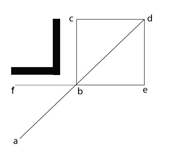

Why all this aggravation with subtraction? Well, the Screwfix tool is a cheap copy (£5) of the proper jobby (£45 from Trend - see below) which has an additional element, see the diagram below:
With this tool you'll notice that eb is extended to f (it's a longer arm) and it's this bit you copy the wall with and just read off the scale, same as an internal.
