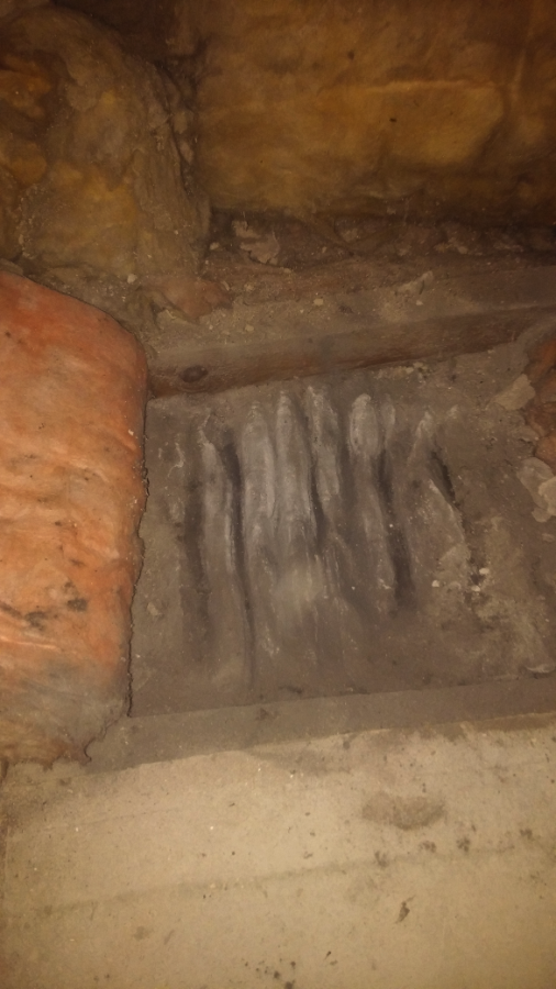

I'm just about to add the brace, what are those lines there? it looks like plaster but it's on top of some black mat. I ant to chisel it away so I have a level floor, is that advisable?
How old is the house? (this is important) and is the plaster greyish white, in ripples, bulging up above the black lines?
And are the black lines thin wood, about an inch wide?
Don't chisel anything away, and don't use a hammer up there.
