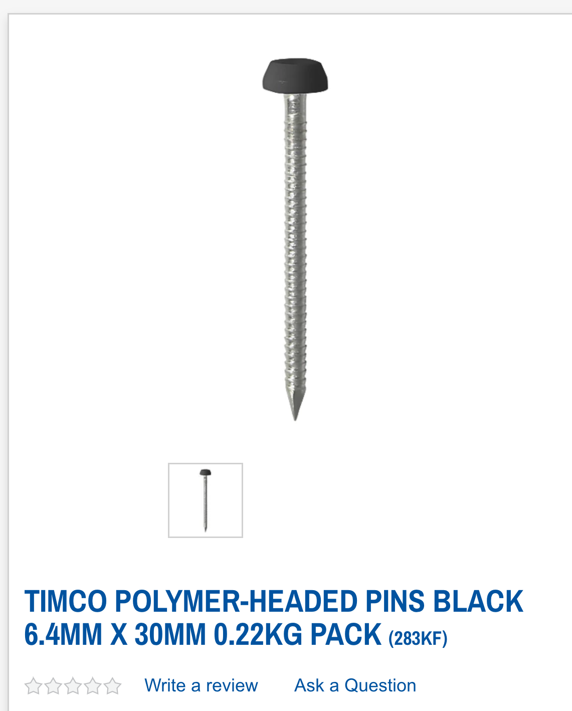

I need black, domed head screws, 30mm, with a nice big diameter head- like a built in washer. Does the collective wisdom have any ideas? Or... can you get black washers lol.
Something like this?
Where are they going to be used?
Check they're woodscrews if using into wood. Many that are available will be self-tappers intended for use into metal so will have a finer thread that may struggle to grip into wood.
Also check if they're corrosion resistant, or you'll have lots of brown streaks in a couple of years. Actually you probably will anyway, whatever they claim.
There are stainless nails with plastic caps specifically designed for cladding. Usually white but I'm sure other colours exist.
Normally there's a trim between soffit boards, you use stainless screws in the trim that is then covered by the next board, so the screws are completely hidden.
Black plastic head pins are often used where they will be seen , it it hollow interlocking or solid soffit?

The other thing to note, if the soffit panels have a protective plastic film applied, peel it before you hammer the nail through it, because the little wisps of plastic left behind if you nail through it then peel take ages to clean up and look awful if you don't
