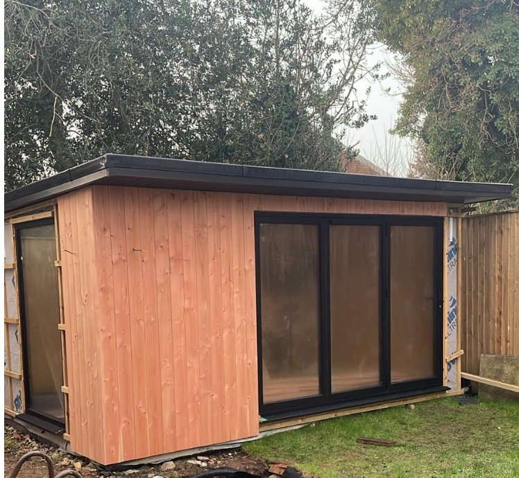

Context: garden room really close to back fence... larch t n g on three sides, so I decided to use soffit on the back. Storm Darragh got between the cladding and the structure and ripped off a few sheets leaving the poly pins in place. In my defence, the edges weren't closed off, letting the wind in, cos the larch hadn't come. Hence the screw idea.

Mrrusty... since you replied AND advised a bit on the project, here's where we are so far... Damn nailer failed twice grrrr!
Noseall, it seems a very common way of finishing these garden rooms, and as a gasher, I'm just following the trend. Why the scepticism?
