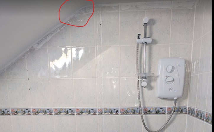

Currently in the midst of a shower room renovation in a loft conversion. I'm a software engineer by trade but mucking in on some of the DIY jobs. We are fitting the Bathroom panels at the moment and because it's a loft room they have curved out the ceiling.
I was wondering what the accepted/best way would be to get the curve cut on the actual wall panel. As per the image below:

Doing straight walls has been fine, but the 900mm boards just come over into the curve annoyingly.
Any help would be greatly appreciated. Equally the end board has that lovely angle on, am I best of just using an Angle Measure for that?

Sorry guys, I meant how would I measure out the shape of the curve on the board...is there a best way to do that?
I've already cut a couple of boards down as did downstairs bathroom but thinking more about the shape at the top.

Measure the angle on the wall-to-ceiling then find a piece of cardboard or stiff paper to make a stencil - line it up to the wall and if you're happy with that, line it up on the panel and get jiggy wid it.

put some masking tape on the tiles
draw a line vertically and a line horizontally, then tape a piece of card which is cut to an accurate rectangle just below the lowest part of the curve, then scribe a line around onto the card -cut it to the shape, push it up to the curve and tape in place, then measure from bottom of card to ground and set out on your pvc
