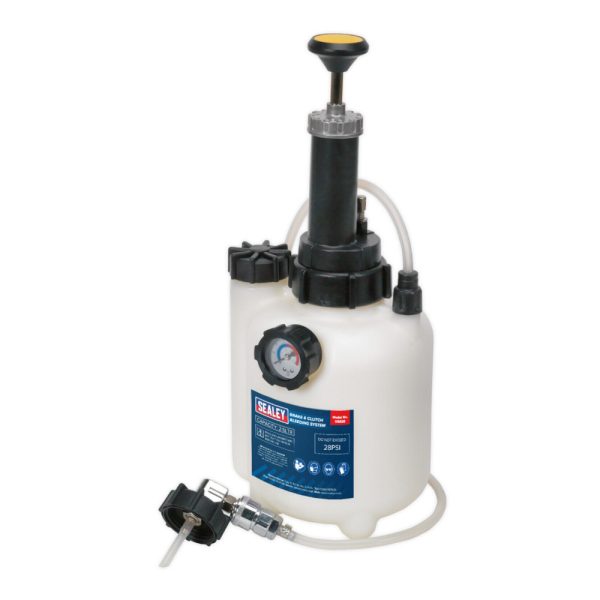

One small thing I need to ask about. I'm changing my mind and may buy a pressure (pump up) brake bleeder as it was a ball ache having to get someone over to help bleed the brakes twice. The Sealey and Laser versions seem to be the same and the cap that screws on to top of resevoir has a small dip tube in it.
When I was topping up fluid level I tried to remove the screen filter that's under the resevoir cap. Tried with fingers and levering a bit with small screwdriver. Would move up half inch or so, but didn't want to come out. I didn't want to force it and wondered if it should come out. However, looking on the online Fiat Eper parts system, the screen is shown as a seperate part/part number.
Should the screen come out? Is there a trick? Would have thought it strange that a filter is designed not to come out - how would you clean it otherwise? The filter would need to come out if using the pressure bleeder or it's going to be in the way of the dip tube which you can see on here -

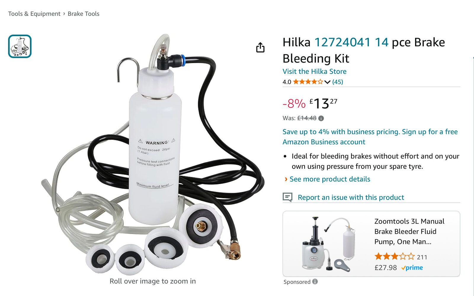

You don’t need to remove the filter to bleed brakes. That brake bleeder will work but a bit overkill for the number of times you'll use it. Why not get something like this:
Thanks, yes realise you don't need to remove the filter to bleed. However, If I was to use the Sealey pump bleeder in my pic, the filter would poss be in the way of the dip tube you can see in the cap in my photo above.
Also may need to remove the filter if I needed to remove fluid from resevoir with syringe, etc.
Just fancied an easy one man bleeder that didn't involve faffing around with spare tyres. May have to think again.
