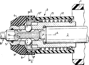

One more question, is the SDS drill accurate?
No. It works on the principal of a hammer and chisel so If it's fine woodworking I'd look at a drill more fit for purpose. I have a floor standing radial pillar drill for woodwork.
