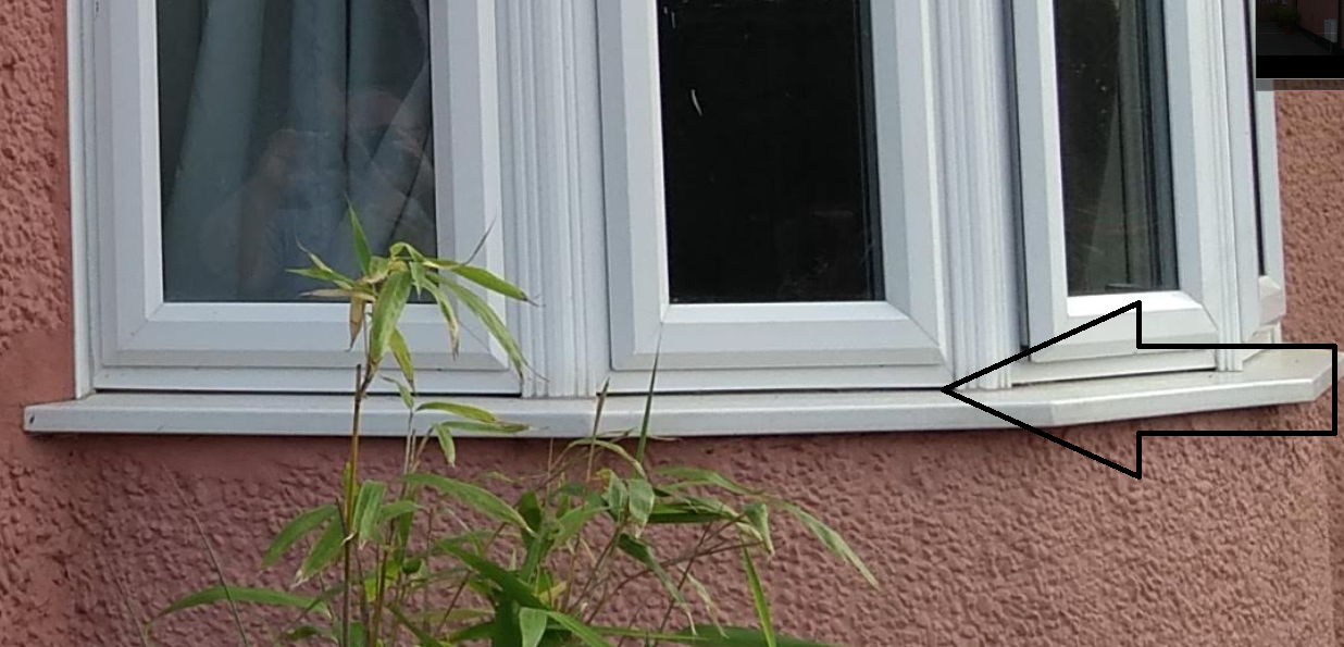

Washed my windows at the weekend and as usual, when spraying hose along the windowsill, loads of dirt and leaves comes out from under the windows.
It there are reason for these gaps? Obviously water tight, but does accumulate a lot of dirt, debris, spiders and stuff.
The water drains through the bottom of the windows, and then out of those gaps
