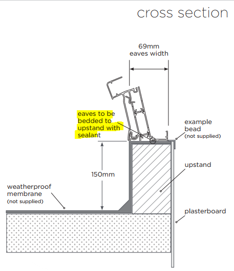

Hi.
Not sure if this should be here or in windows and glazing. Any particular/preferred sealant for installing a aluminium roof lantern onto a GRP roof. I'm assuming a good quality frame sealant is what is needed?
Cheers.
Polymer. But you should not be relying on just sealant, there should be a cover shroud or flashing over the joint.
Thanks. The sealant is to be used as below in the diagram.
That's a very poor design.
Not only for the lack of a cill or drip, but that appears to be a gap between the frame and the upstand which is a water trap and what is to stop the frame edge puncturing the roof cover from load or thermal movement? Not good.
And there should be a bit of vertical insulation around the perimeter of the upstand (like around a floor slab) to minimize cold bridging.
Yes, run some 25mm of celotex around the opening - upstand and the joists
