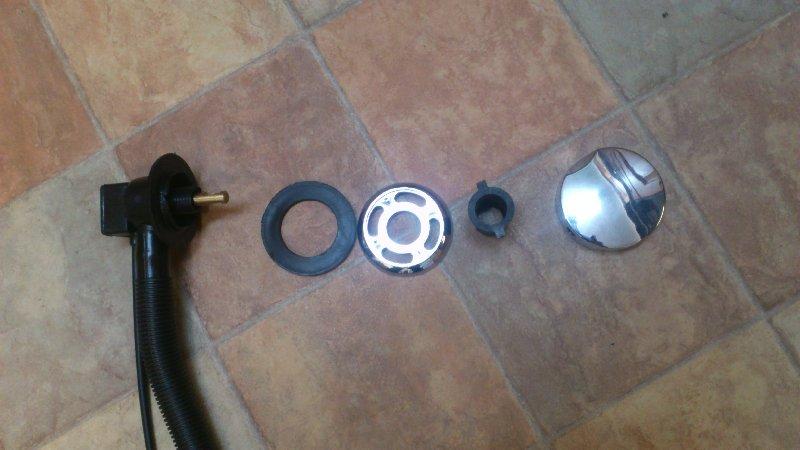

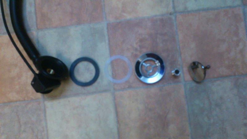

hello again , bath arrived today , the waste has 2 seals for the back
first one that should go on is clear 2nd a thicker black 1 ,
should i use the the thin clear one or not
also do i need to put silicone on the overflow ,
I think the clear one is probably for inside the bath (the one I would discard). Some silicon on the overflow is a good idea, particularly where the ribbed flexi pushes on, unless you have one with the o rings inside which tend to be ok.

Yes the black washer goes underneath on the waste body and the clear one is the one you don't need - mastic instead.

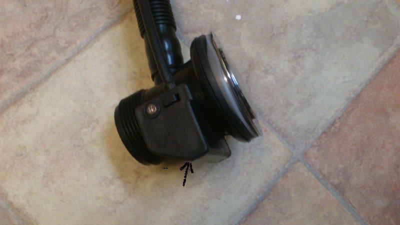

hi , thought i would let all know how i got on ,well there good news & there is bad news ,good news when bath is full of water no leaks surely that means that the seal is good , bad news when i drain the water there is a very slight leak coming from the part of the unit where the cable for the plug control is situated run my hands above the leak to try to see where it's coming from hands are dry
Sorry crooner but I can't really say what that is unless there is a crack or something??
