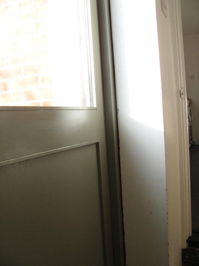

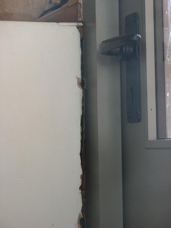

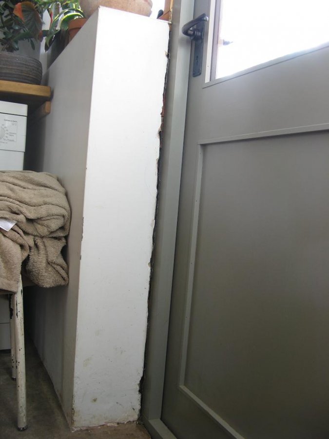

We recently had a new back door fitted and need to fill/seal the gap INDOORS where the frame meets the wall.

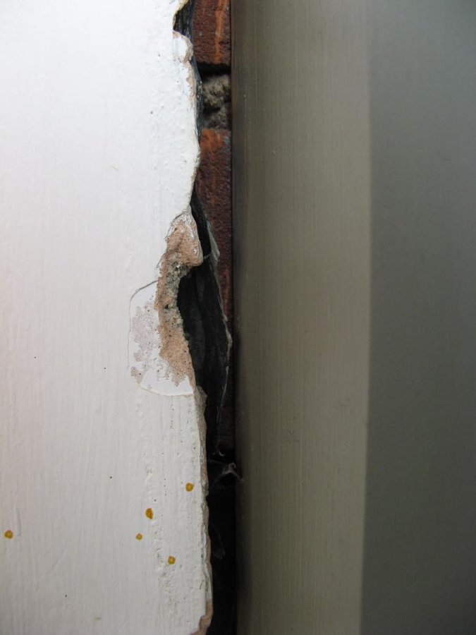

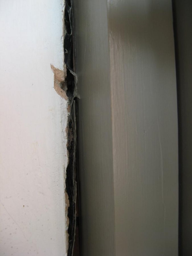

Down the left hand side the gap ranges from around 10mm to 15mm. It's a much smaller gap along the top and right hand side.
It's also quite deep. At some points it's around 15mm, but at other points there doesn't seem to be a "back".... If I push my 15cm steel ruler in it just keeps on going. Do I need to use some kind of backer?
There is also the plastic in the gap as can be seen in the photos. Is this some kind of damp proofing??? Will it cause any problem for what ever I use to fill the gaps?
The top and opposite side have much smaller gaps so don't know if I need to use the same or something different in those spots?
Any advice and help would be most gratefully received.
Cheers all
Max
(PS - wasn't sure which forum to post this one in.... Please move if there is a more appropriate one. Thanks.)

Probably the easiest way for you here Max is to get in there with some ready mixed patching plaster.....push it well in, and finish with a wet brush.

It,s expanding foam adhesive , fills and glue any loose material , won't be dislodged by banging door unlike just filling with plaster or filler and will fill all voids .

Both have their good points, Max.....plaster is more brittle, foam doesn't paint well. Any excess foam should just expand out of the joint without trouble, then you could cut it back when cured, maybe to plaster on top.
I don't have any problems with plaster falling out, personally and if you're not too good at getting a good finish straight from a blade, a wet paintbrush does it for you.
