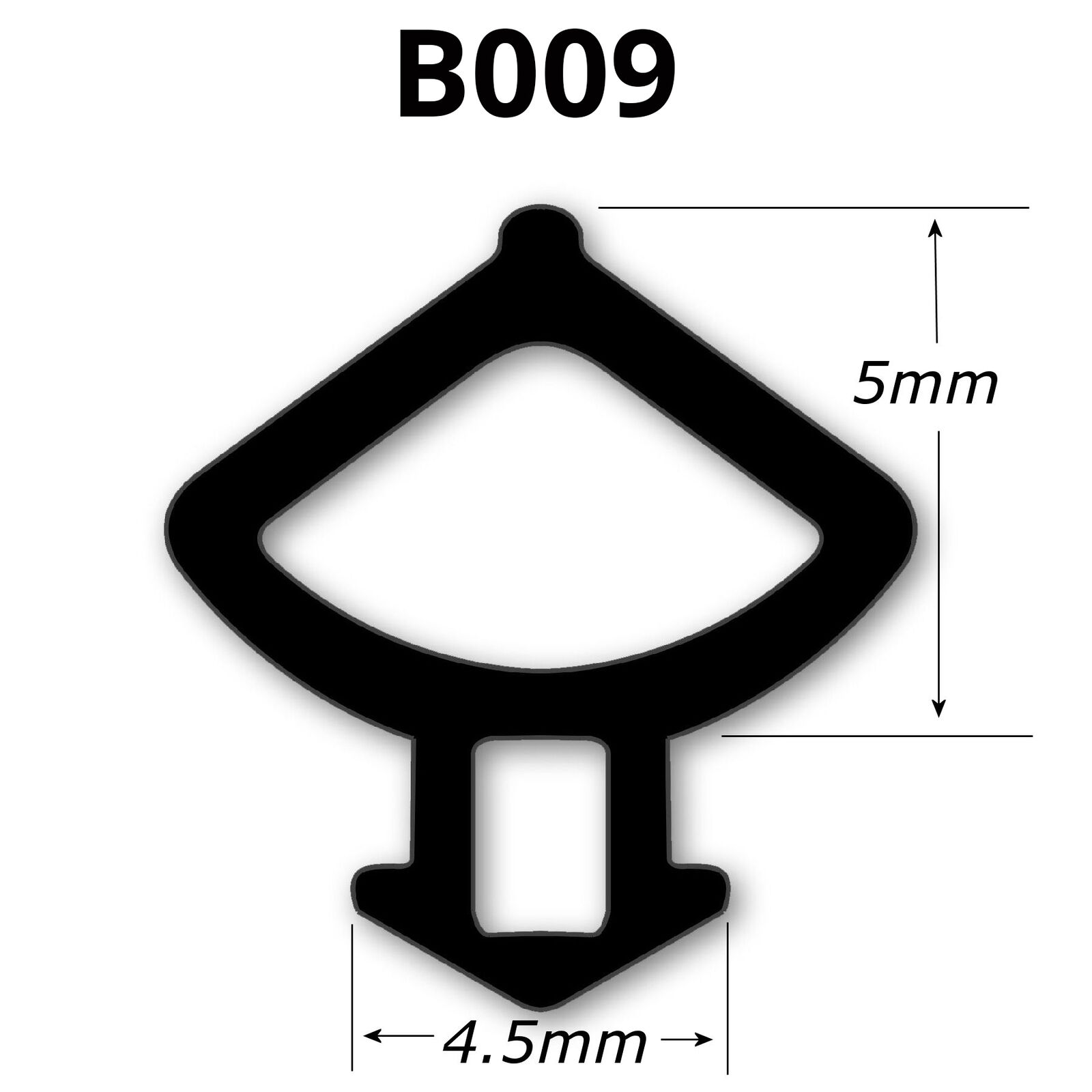

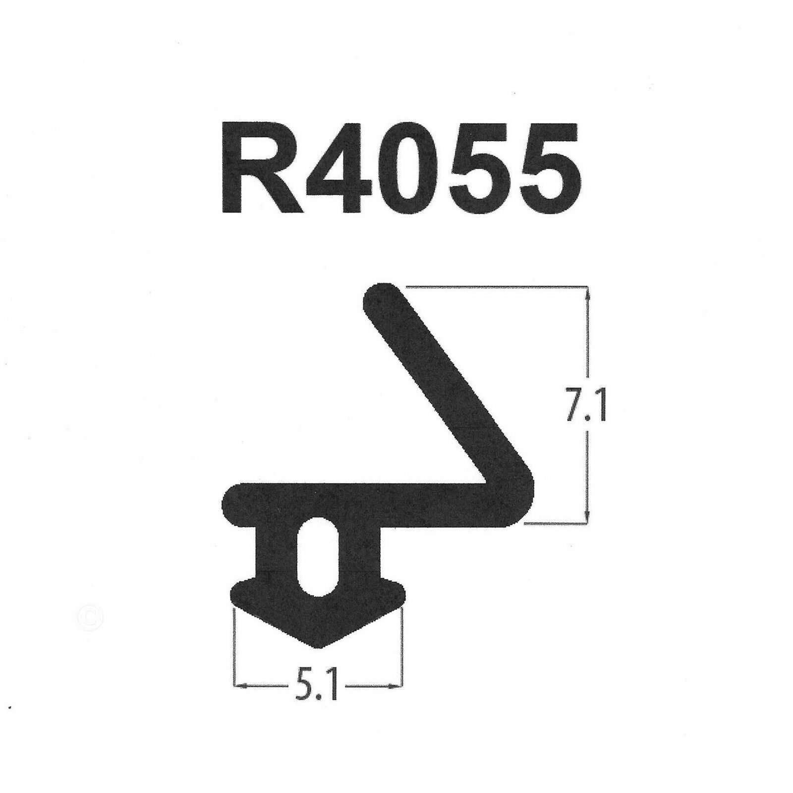

Can you try different seals from the ones fitted.
I ask because of a single layer gasket like the one I have fitted. Isn't going to produce as much thermal protection as one with two layers? Mine is the R4055, was thinking maybe the B009.

I can't comment on your exact windows, however normally with gasket you don't want to stretch it when fitting. It should be installed under its normal tension if that makes sense?
As diy_fun_uk says definetly don't stretch it , or it will eventually ' shrink ' back and leave a gap. Gaskets are one of those things that are incredibily hard to be 100% accurate about as a replacement , as they are measured in such small sizes and each ' groove ' they go in can be different ( eg that B009 may well just slip out of the groove being 0.6mm narrower ) . Best bet is the gasket samples , readily available on the likes of Evil BAY, but bear in mind they are only a small selection of gaskets available. And in answer to your question about which one is best , as long as they keep the water and wind/air out , it will make no noticeable difference . One is a ' bubble gasket ' one is a ' flipper ' gasket , and they work is differing ways
Surely more material, in general, will offer more resistance to water/wind especially from a thermal point of view. I guess I will have to measure the gasket more closely and make a choice and do a bit of trial and error. At least it's not a generally expensive material to play around with.
